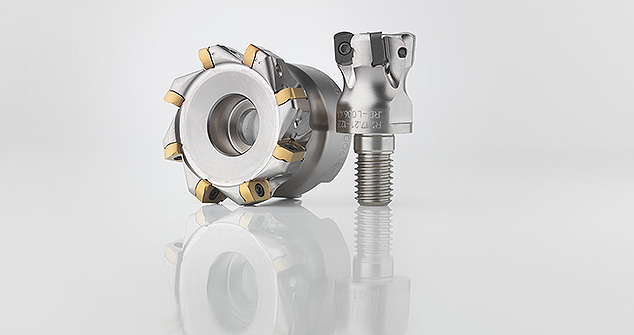

Highfeed 4 cutters have doublesided inserts with four cutting edges

Highfeed 4 cutters feature LO06 double-sided inserts with four cutting edges for cutter bodies that range from 1.00 to 2.50 in. diameter. Available in four different insert geometries (ME, M, MD and D), these close-pitch and negative-pocket LP inserts cost effectively machine common workpiece materials. Mounting types include Combimaster heads, cylindrical shanks and shell ends.
