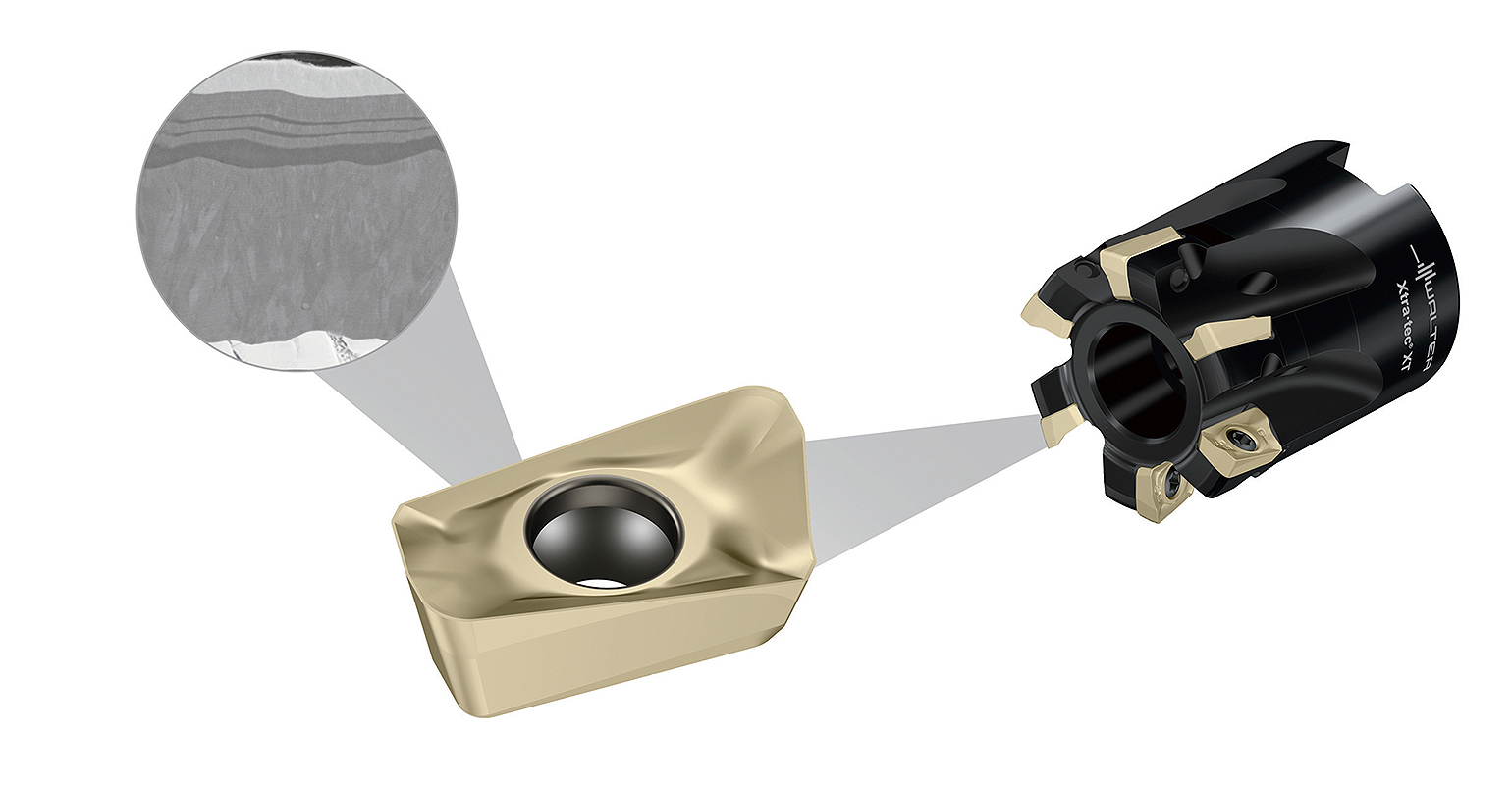

Milling insert coated with a multi-layer PVD Al2O3 coating on a carbide substrate, for cutting-edge stability and long tool life, as well as process reliability even in complex applications.
WALTER is expanding its Tiger·tec® Gold range inserts with the new WSM35G milling grade. The indexable insert is coated with the only PVD Al2O3 coating technology of its kind to date with a multi-layer structure on a carbide substrate. The structure consists of a bottom TiAlN layer for high wear resistance; a middle Al2O3 layer for high temperature resistance; and a ZrN gold-colored top layer for minimized friction and the best wear detection.

This new grade has been applied to inserts for all standard milling cutters in the Walter lineup, such as the Xtra·tec XT M5130 shoulder milling cutter, and many more.
