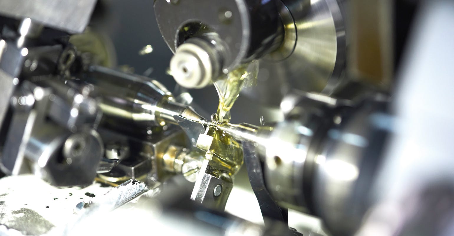

ZELLER+GMELIN is expanding its metalworking lubricant portfolio with Multicut SE 13, a multifunctional machining oil suitable for numerous processes. With high thermal stability, low evaporation rate, and minimal smoke generation Multicut SE 13 is proven for both conventional gearbox manufacturing and e-mobility components.
Multicut SE 13 is effective for a wide range of metalworking processes, including turning, milling, drilling, grinding, honing, broaching, and deep-hole drilling. Even under highly variable machining conditions, such as in automated production lines or with complex component geometries, its lubrication performance remains stable. The combination of high-quality hydrocracked base oils, synthetic greases, and coordinated EP additives ensures reliable performance even under high thermal and mechanical loads.
