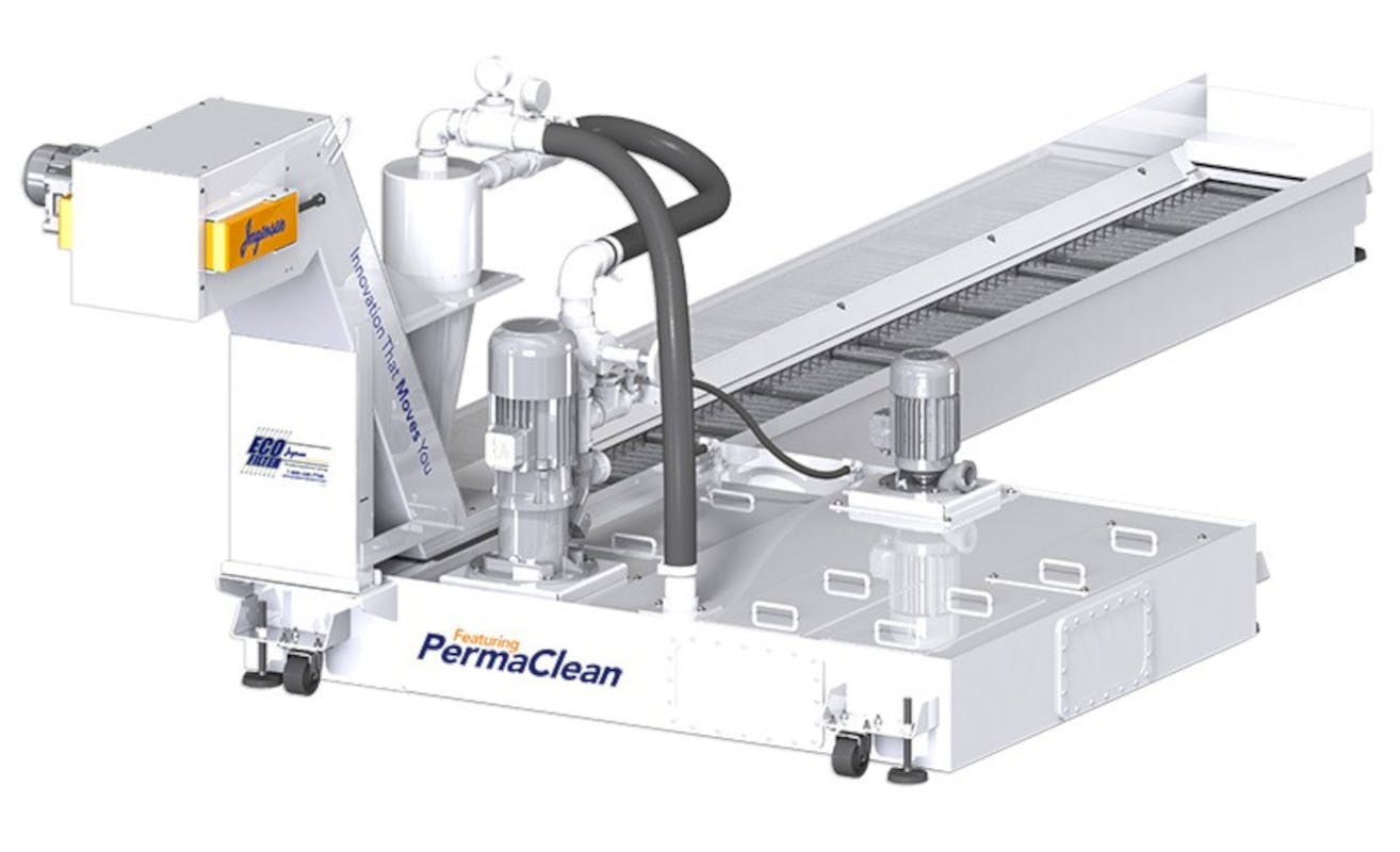

Jorgensen’s new EcoFilterÒ 80 self-cleaning conveyor conducts efficient filtration of fine chips to 80-microns nominal. It is the first economical non-drum style conveyor offering filtration below 100-micron. EcoFilter® conveyors use non-disposable filter boxes that dramatically reduce chips and particulate from migrating to a machine tool coolant tank. Users experience reduced downtime for tank cleaning and maintenance as well as improved pump, tooling and coolant life.
The new EcoFilter80 will be part of Jorgensen’s new PermaClean system that adds options for secondary tank filtration and eliminates sludge build-up by adding agitation to the coolant collection tank. PermaClean can be incorporated into Jorgensen’s multi-step filtration system and is adaptable as an option to nearly any filtration system on the market.
