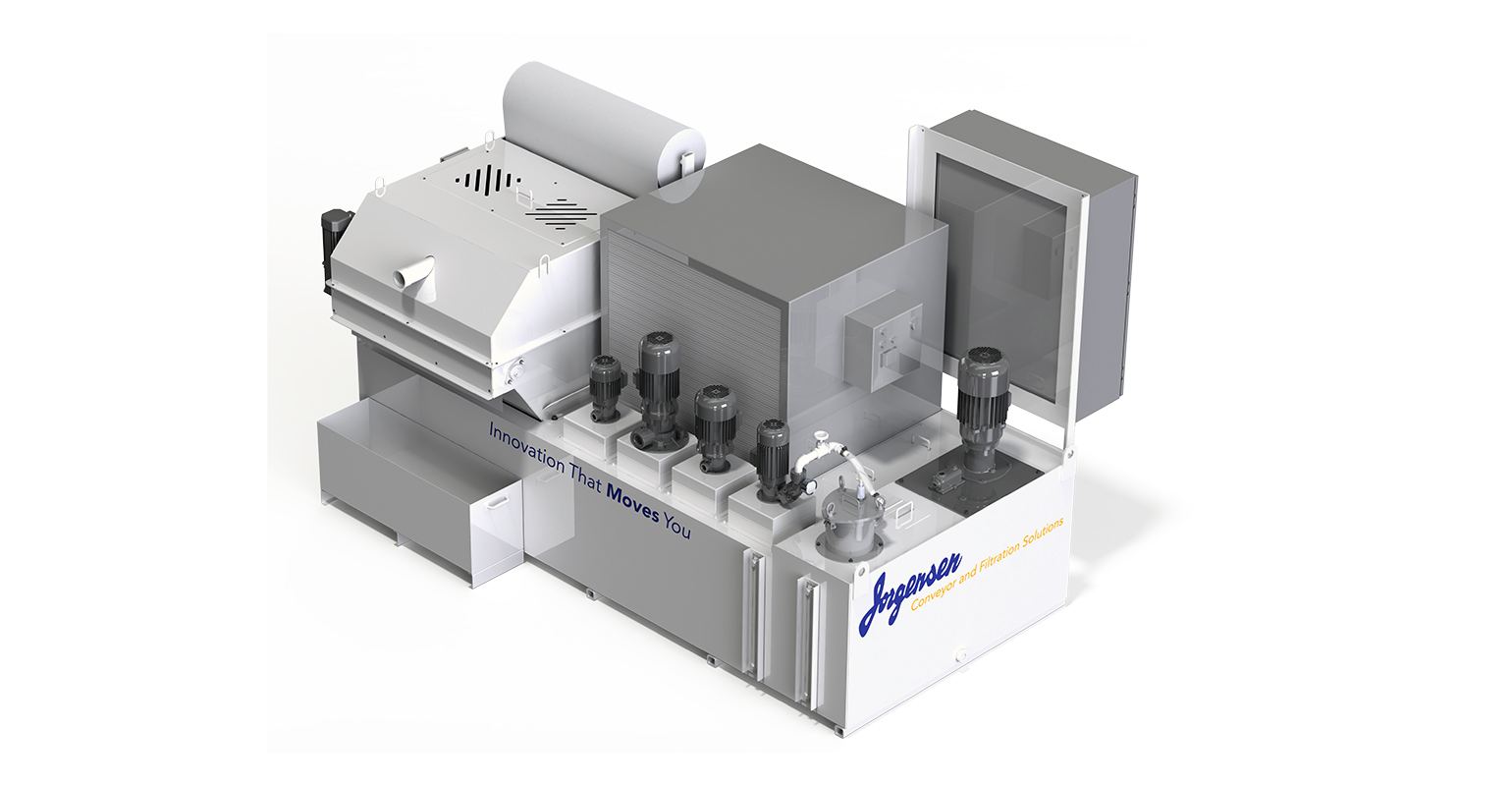

JORGENSEN CONVEYOR and FILTRATION SOLUTIONS will spotlight its new FlexFiltration line at IMTS 2022 – booth 338164 – including the new Flex G Series modular filtration systems. The cost-effective systems feature pre-engineered modules that ensure fast, easy, flexible filtration configurations and add value for virtually any application.
FlexFiltration systems efficiently remove fine chips and grinding sludge to achieve coolant clarity down to 10 microns or less. They are well suited for challenging applications with materials that range from cast iron, steel, and aluminum to composites and plastics.
Pre-engineered base configurations and numerous options enable quick construction of FlexFiltration systems to meet specific coolant-flow requirements. Standard, low-profile, and stainless-steel tanks make these systems ideal for machine tool OEMs and regular end users. Other modular options that complete a system include high-pressure pumps, auxiliary pumps, tramp oil skimmers, coolant chillers, heat exchangers, liquid level sensors, temperature sensors and the ability to control/interface with existing pumps and other equipment.
Jorgensen’s Flex G Series systems feature gravity media filters. The gravity media filtration option is the first one available in the FlexFiltration product line. Gravity filters are offered in 30-, 60-, and 90-gpm options and come standard with low media roll detection, no media alarm sensor and automatic roll advance. A variety of different disposable cloth medias are also available based on specific applications. Additional primary filtration options including bag filtration, cyclonic, and permanent media types will soon be offered.
