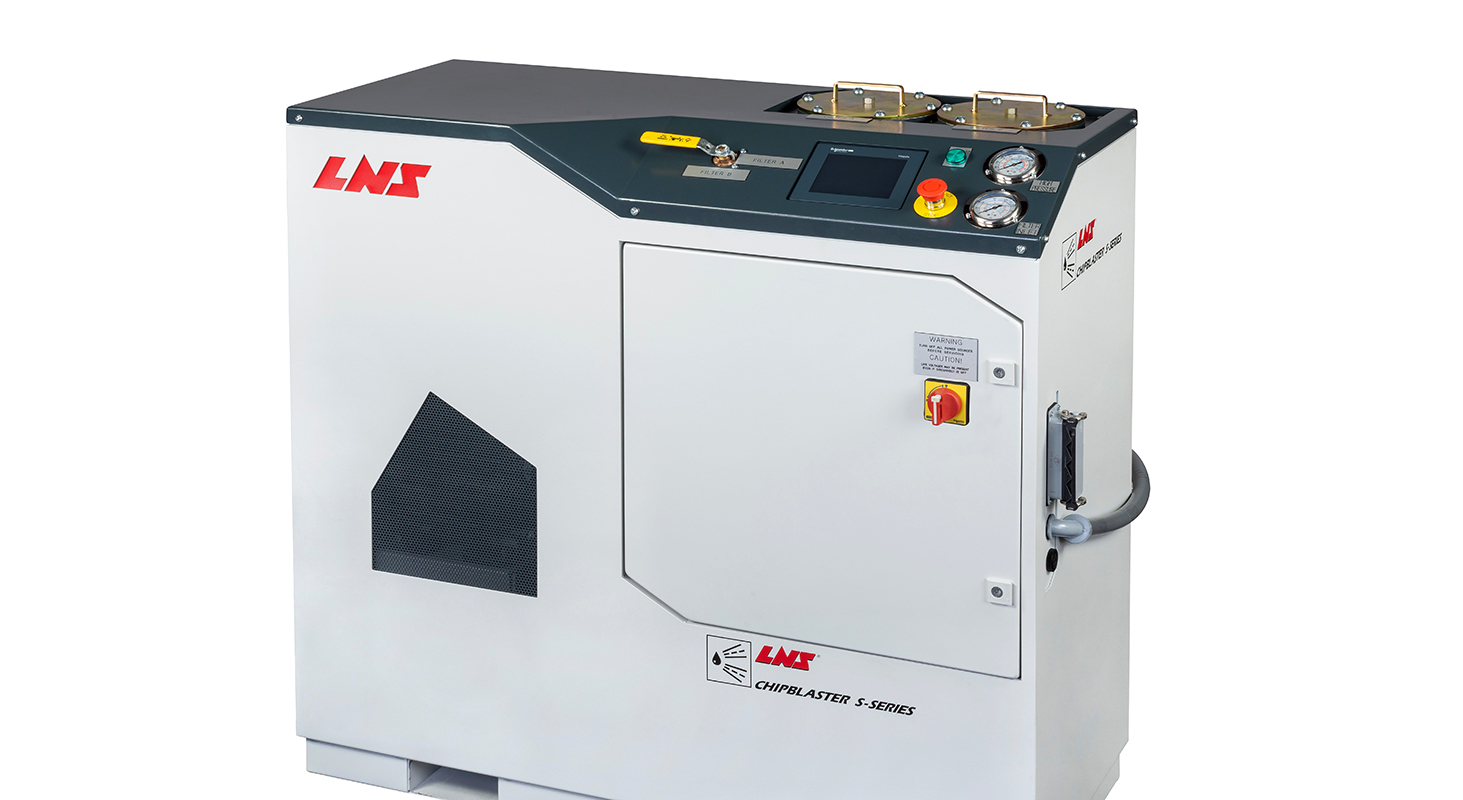

The new LNS AMERICA Chipblaster S-Series coolant systems improve CNC machine performance, take up less floor space and are easy to install and maintain. S-Series machines are available in fixed or variable-rate (flow and pressure) models. The variable-rate units have tool interfaces that provide independent control of 1, 4 or 8 coolant options, depending on the number of installed coolant-enabled tools. Fixed flow units have one coolant outlet.
A dual-cartridge filtration system that filters to 10 or 5 microns is standard on fixed flow model S-30 and variable flow models SBV-70 and SBV-140.
Changing filters is quick and easy while the unit continues to operate without interrupting production. The S-30H fixed flow model has a maintenance free cyclone filter that requires no media change and filters coolant to 2 microns.
Variable-flow models have a user-friendly HMI that allows easy adjustment of preset pressure values, changes to settings, and monitoring of various operations. Multi-directional casters enable easy installation and maintenance.
