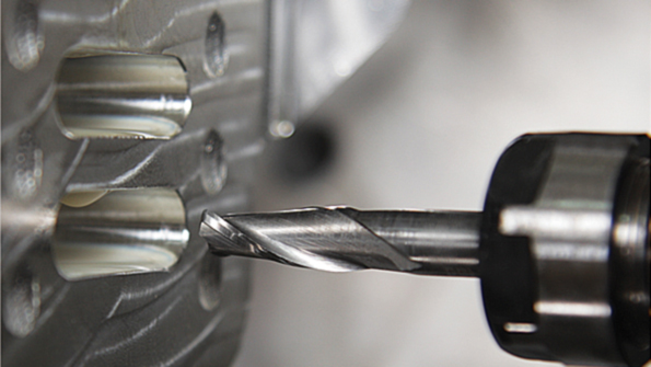

As reported by Delcam, among the new functions in PowerMill 2015 will be an updated Vortex high-speed area-clearance strategy (introduced at IMTS 2012) that produces safe toolpaths with a much deeper cut by using a controlled engagement angle to maintain the optimal cutting conditions for the whole toolpath.  As a result, higher feed rates and material-removal rates are possible, making the cutting time shorter by as much as 70%.
In addition, cutting proceeds at a more consistent volume-removal rate and at a near-constant feedrate, so extending tool life and protecting the machine.
Two enhancements in PowerMill 2015 will give even greater reductions in machining time compared to conventional roughing. The first change allows toolpaths to approach the part from outside the stock at the cutting height for open pockets or in areas where earlier cuts have made this possible.  Previously, all entry moves had to be made by plunging onto the surface or by ramping into the material.
The second change allows an increased feed rate to be set for non-cutting moves. The default value is set at double the rate for the cutting moves but this can be altered as required for each machine tool.  The extra time that can be saved depends on the shape of the part but an additional saving of around 20% should be expected above the earlier releases of Vortex.
