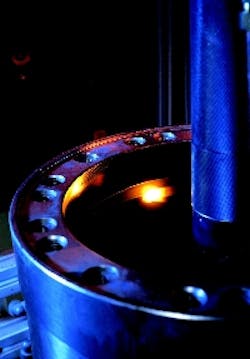

A laser system used for heat treatment has a laser source, a beam-delivery system and focusing optics. The system is normally incorporated into a multi-axis machine that allows for at least 5-axis numerically controlled work.
The beam exiting the laser is poorly formed for heat treating because it has hot spots and weak areas. It can, however, be shaped into almost any desired pattern using a number of different devices, such as multifaceted segmented mirrors, integrators and scanners. Mirrors always produce individual stable beam patterns that are built into the devices. Integrators and scanners are adjustable and generate a wide range of beam patterns. While these devices tended to be too fragile for production environments, recent developments in scanners have made them more robust.
