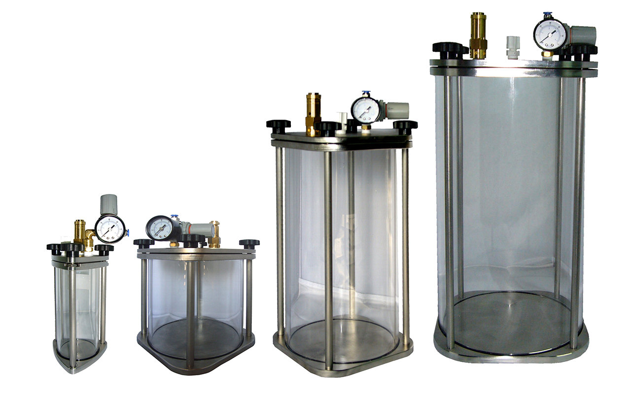

Surprisingly, the top-to-bottom effect has been fully investigated by scientists and engineers only in the last few years. Essentially, it gives an indication as to why a fluid’s performance changes dependent on the amount that remains in the container when all other parameters are set. In manufacturing terms, operators have long noticed a steadily decreasing flow rate when using a time / pressure system.
The top-to-bottom effect is caused by the constant change in volumes of air and fluid inside the vessel. As the fluid level goes down inside the vessel, the volume of air increases but the ratio of compressed air, at a given pressure is not linear in comparison to that of the fluid.
To put it simply, at constant pressure, an increasing volume of compressed-air cannot sustain a consistent pressure on a fluid, therefore generating a different amount of force. This can be understood when you consider one of the fundamental differences between pneumatic and hydraulic law, namely, that air is indefinitely compressible whereas water and a vast majority of fluids are not. As such, air is always the variable and yet it is an essential part of a process that requires consistency.
The solution to this can be pieced together by a determining the right-sized vessel and managing the pressure in a more precise way, enabling control over the amount of compressed air inside the tank, to deliver a consistent amount of force.
