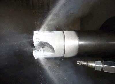

A Cryogenic CYCLO CUT Hi-Feed milling cutter designed for Minimum Quantity Cryogenics machining discharges liquid nitrogen through cutter inserts.

The first-of-its-kind technology, MQC delivers liquid nitrogen at -321 degrees through the spindle, directly to the tip and cutting zone to create a heat sink effect rather than the traditional chip zone cooling with wet coolants.
The result of this innovation, said MAG, is increased process speeds of as much as 60% while milling CGI with carbide and up to four times using PCD (Polycrystaline Diamond) tooling. It also boasts improved lifecycle costs for cutting difficult-to-machine materials by reducing the required number of machines and associated plant infrastructure.
