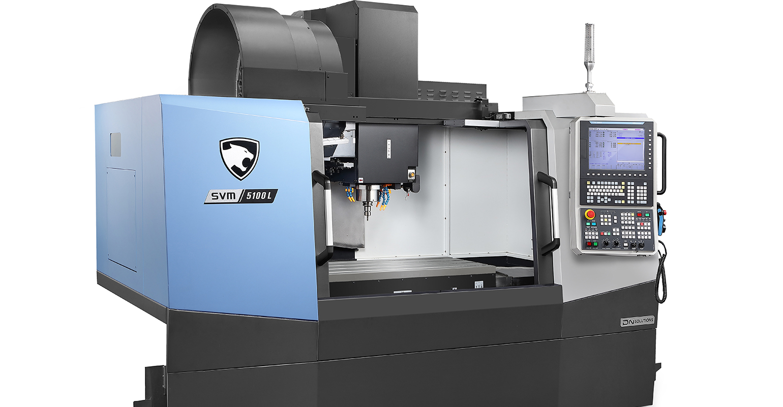

DN SOLUTIONS (formerly Doosan Machine Tools) introduced the new SVM 5100L vertical machining center, a larger version of the SVM 4100 that fills the market space between DN’s DEM and the DNM series.
“The SVM 5100L is another example of DN Solutions filling every niche our customers work in,” according to Andy McNamara, vice president of sales and marketing. “As more diecast components are used in higher production environments, the demand is growing for high-speed, light-cutting applications.
“The SVM 5100L incorporates a traditional C-frame design structure that is optimized to meet those needs,” he continued. “With its addition to the lineup, customers can now choose between different sizes of SVM models. And of course, for more robust materials, the best-selling DNM line is always available.”
Like the smaller 4100, the SVM 5100L’s performance has been optimized to provide shorter cycle times by reducing the acceleration/deceleration times of the XYZ axes and spindle, thereby minimizing non-cutting time.
The 25-hp (18.5-kW) motor on the SVM 5100L turns the spindle at a speed of 12,000 r/min, which generates 70.5 ft-lbs. (95.5 kW) of torque. The X- axis travel is 50 in. (1,270 mm), and Y- and Z-axis travel is 20.1 in. (510 mm.) The maximum table capacity is 1,763.7 lbs (800 kg) and the rapid federate is 1,417 ipm (36 m/min.)
While it is affordably priced, the SVM 5100L is not a stripped-down machine model. This VMC is packed with standard features that other machine tool manufacturers often charge extra for, including a CAT 40 BIG-PLUS spindle system, through spindle coolant and a double-arm ATC with 30 tools.
A FANUC 0i-Plus control with iHMi touchscreen interface is also included in the base price. It has AICC II and nano interpolation built in to allow a faster, more accurate profile and finish.
