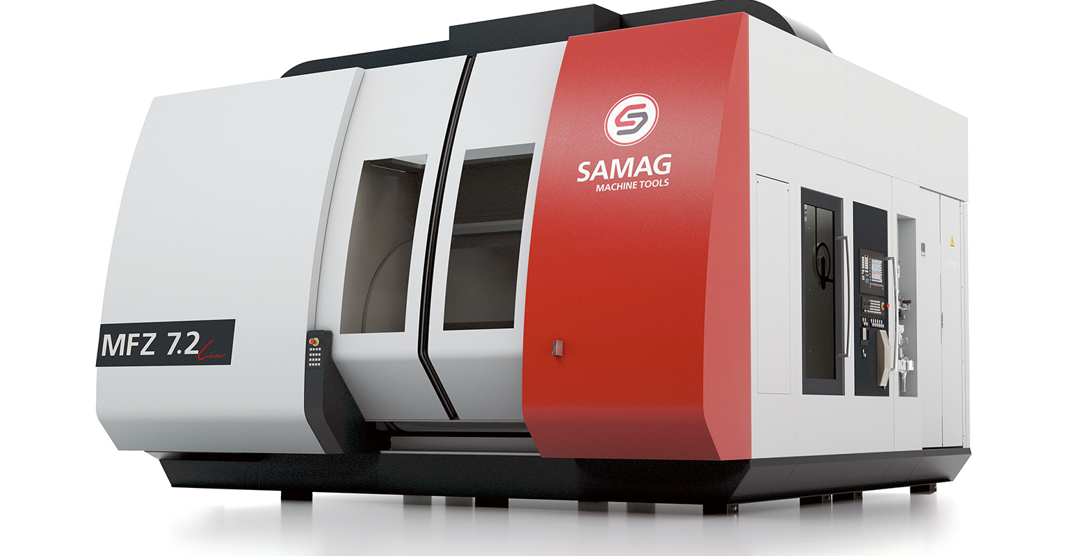

SAMAG, in Saalfeld, Germany, with offices and service centers worldwide, engineers and builds a variety of multi-spindle machines under the MFZ Series brand, for high-volume cubic workpieces.
Multi-Spindle Horizontal Machining Centers
March 19, 2020
Samag MFZ Series machines and deep-drilling machines are available for high-volume production, such as knuckles, engine blocks, gear boxes, valves and connecting rods.
GERMAN MACHINE TOOLS of AMERICA (GMTA) is offering a full line of Samag multi spindle machining centers for the North American market. Samag, in Saalfeld, Germany, with offices and service centers worldwide, engineers and builds a variety of multi-spindle machines under the MFZ Series brand, for high-volume cubic workpieces.
Samag supplies complete turnkey packages, including tooling, work holding, robotic articulation, parts handlers, and transfer mechanisms for high-production work, such as knuckles, engine blocks, gear boxes, valves and connecting rods.
With “FIT 2 PART,” the modular construction kit of the multi-spindle horizontal machining center has been developed consistently from the point of view of the workpiece. The X, Y, and Z axes of the two-spindle machine can be corrected independently of each another.
Four sizes and two types of drive offer options for high-speed machining and heavy-duty cutting.
The number of spindles, the variable distance between them, and the extendable tool magazine allow machining of diverse workpiece dimensions and capacities.
All models are available with a linear or ball screw drive and up to four working spindles. Five-axis simultaneous machining and a workpiece feed during primary processing time is possible.
The rock-solid machine bed, filled with Hydropol®, is thermally stable with excellent damping capability.
