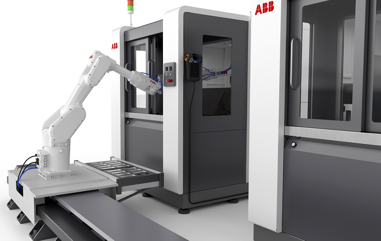

An IRB 2600 robot, a controller, and a turntable combined with pressure and level sensors and other equipment make up the OmniVance machining cell, with all components pre-tested to guarantee compatibility. 90% of the cell is already built, meaning users only need to focus on tooling and robot calibration. ‘Pre-engineering’ results in a faster set-up and more compact footprint to ensure that cells can easily integrate into a wide range of production environments, and a standardized design makes it possible to run up to eight different functions on a single cell often by simply changing the end effector.
The OmniVance machining cell has been evaluated with real-life stress tests on 2,400 cells, resulting in a highly durable and stable solution suitable for harsh conditions and capable of running unsupervised for 20,000 hours before maintenance is needed.
ABB’s machining software is the first to integrate auto-calibration and path-tuning functions into a single intuitive tool. This simplifies the process of setting up new products while maximizing accuracy in machining applications including sanding, deburring, polishing, and dry ice cleaning. It is a standalone tool that supports the IRB2600 robot used in the machining cell as well as a wide variety of robots from ABB.
The machining software calibrates tools and work objects automatically, reducing re-calibration time from four hours to just ten minutes. Integrated path tuning functionality enables users to easily edit thousands of path points in just half a day, compared to the two days typically needed to obtain a high-quality surface such as that of a cellphone case or an aluminum wheel.
