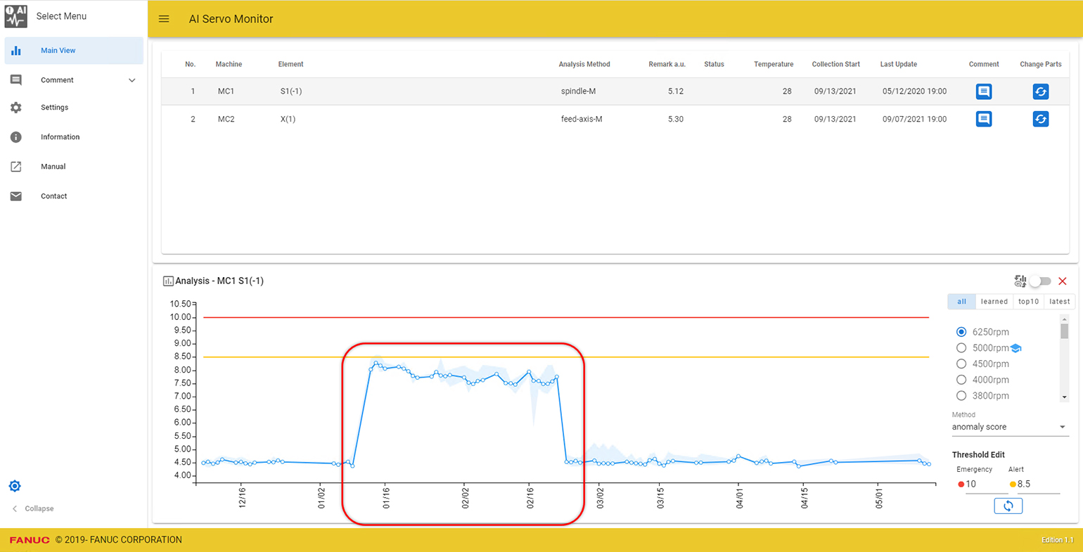

FANUC introduced a new Industrial Internet of Things software designed to prevent production problems before they happen. AI Servo Monitor uses artificial intelligence to predict possible failures of the drive systems for FANUC servomotors and spindle motors.
AI Servo Monitor, in conjunction with MT-LINKi through machine learning, analyzes the daily performance of machines equipped with FANUC CNCs. Daily data is displayed in intuitive graphs which allows users to easily monitor abnormalities on these machines. Artificial intelligence automatically creates a baseline model of the machine while running in a normal state. An “anomaly score” developed expresses a difference in the baseline model and the daily recorded values. On a web interface, users can easily see the anomaly scores in a graph. Plus, email notifications can be issued if this value exceeds the predefined thresholds.
“The power of IIOT software is that it detects a failure before it happens, not after,” stated Jon Heddleson, general manager of factory automation for FANUC America. “Predictive maintenance is key in preventing unexpected downtime. FANUC’s AI Servo Monitor helps ensure that production keeps running smoothly.”
