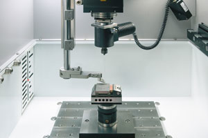

A good example of a fine-hole drilling fixture is the Fine Drill module for GF AgieCharmilles’ Form 20 die sinking EDM. It's capable of deploying small-diameter electrodes as a System 3R high-speed rotation spindle drives them at 60-2,000 rpm, ensuring positioning and roundness accuracy. High flushing pressure up to 80 bar integrated in the diesinking machine’s dielectric circuit maintains clean spark gaps.

The Fine Drill module’s arm and guide structures support small-diameter electrodes as a System 3R high-speed rotation spindle spins them at speeds between 60 rpm and 2,000 rpm to ensure positioning and roundness accuracy. High flushing pressure up to 80 bar integrated in the diesinking machine’s dielectric circuit maintains clean spark gaps.
The Fine Drill module can run electrode diameters measuring from 0.004 in. and smaller. And, the module is an option that can be added to the Form 20 at the customer side. GF AgieCharmilles also has integrated special software features and technology parameters for the Fine Drill module into the Form 20’s CNC.
