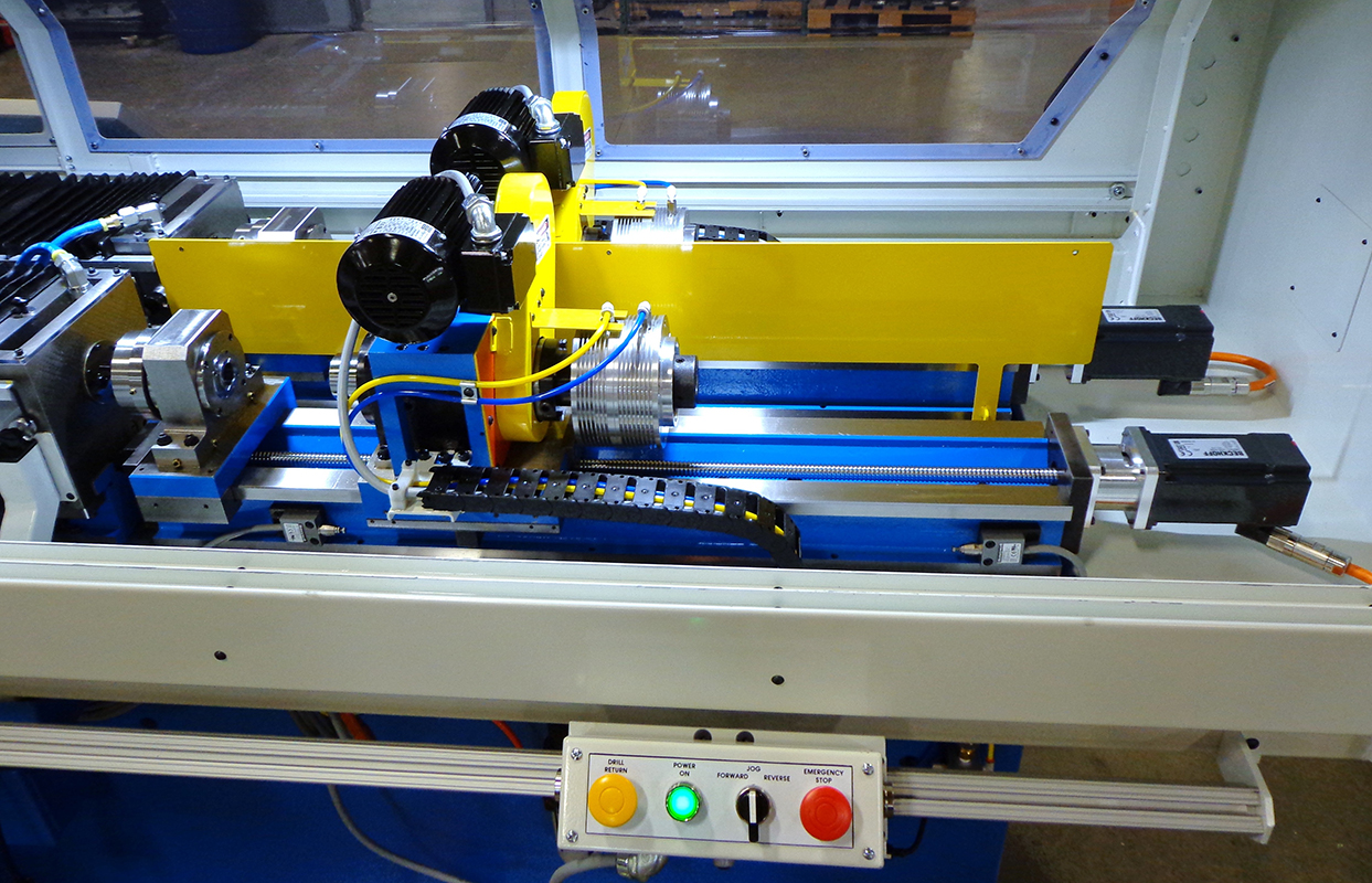

The KAYS ENGINEERING INC. Eldorado M75-30T gundrilling machine now features an option for a servo-driven fixturing assembly, meaning that the machine operator is now able to load and unload parts more quickly, and from a more ergonomically sound position.
The M75-30T features a counter-rotation fixturing assembly that grips the tailstock end of the workpiece. It rotates the workpiece in the opposite direction of the gundrill tool rotation, which improves the accuracy of the drilled hole.
With the servo-driven option, a Beckhoff servo motor rotates the ballscrew, which provides advance/retract motion for the counter-rotation assembly.
The servo-driven movement of the assembly is an improvement over the previous manual handwheel actuation. Operated with a toggle switch, the servo-driven option is faster, more repeatable, and eliminates repetitive motion for the operator. Safety features include a torque limiter on the servo drive and mechanical limit switches on the slide. These features prevent the operator from crashing the fixturing assembly and damaging the machine.
