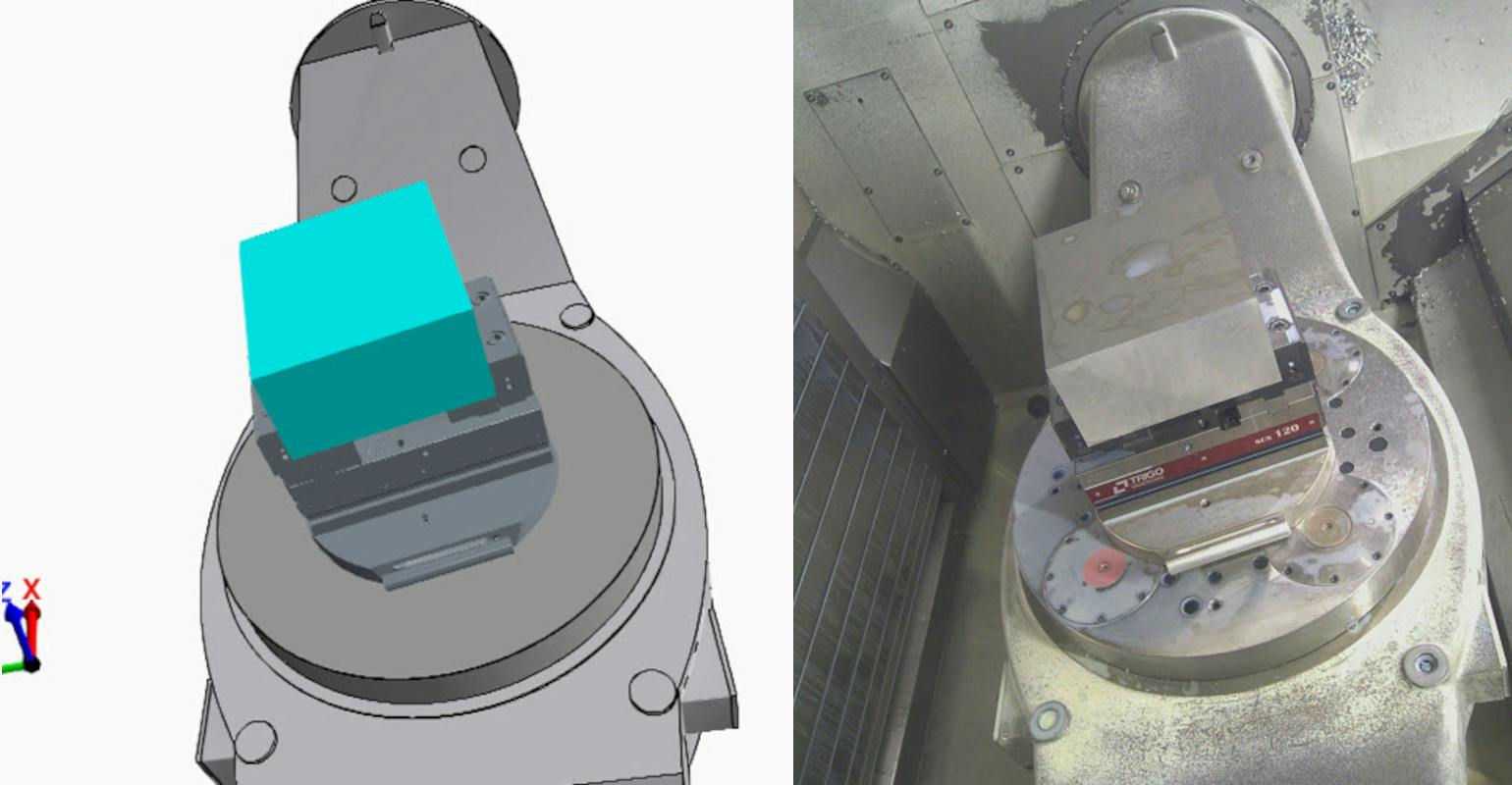

Even the most accurate digital twin cannot compensate for an incorrectly set up machine. Small discrepancies between the planned and actual workholding set-up are among the most common sources of errors in day-to-day production.
To reduce this risk, CHIRON uses a camera-based validation system designed to improve machine safety and prevent set-up errors, whether caused by human error or, in automated production environments, by robotic systems.
During set-up, a camera monitors the machine's working area. It assists the operator in checking key aspects such as the position of the raw material, workpiece clamping and any foreign objects in the work area — from tools accidentally left inside the machine to other objects that should not be there.
Based on the digital twin, the system generates a reference image from the same perspective as the installed camera. Before machining begins, this reference image is compared with a live image of the actual machine.
Production starts only after the operator has approved the set-up. From this point onward, CHIRON ProtectLine provides real-time protection during the machining process.
