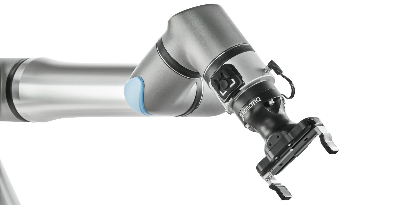

Artificial intelligence is the coordinating principle guiding UR’s new platform. Gen 7 introduces three new cobot arms with progressively higher payloads and reaches, all outfitted with an AI-capable tool flange. The g-Series tool flange makes it possible to deploy vision and sensing capabilities that coordinate with AI in real time with the robot, bringing data, power, and safety control to the business end of the cobot. There is no complex cabling required, opening the possibilities for cameras and high-bandwidth sensors to coordinate with advanced automation programs.
Also, the cobot is able to adopt built-in force-torque sensing, impedance control, and Real-Time Data Exchange (RTDE) functions, making it compatible with physical AI applications like tool manipulation and assembly work.

Another teach/program option is the SP7 Smart Panel, for installing commands directly at the tool flange. Smart Panel allows operators to work at the point of a task, cutting set-up and programming time where touch-to-teach or operator interaction is important.
