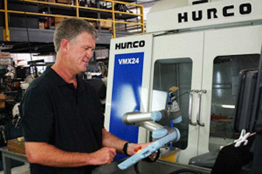

In addition to the tube-bending function, the robot arm was integrated in the milling cycle with a Hurco CNC machine to execute a monthly order for 700 valves. “Our CNC machine normally produces 400 valves per month with two shifts, so we would have been forced to buy another machine even if we put a third shift on,” Escalette explained. “With the higher run-rate using the UR5, none of this was necessary.”
The California company put the UR-robot to work 24/7 and met the order in 11 days, while opening up 30% more capacity on the existing machinery.

Total setup time, including all programming and tooling, took eight hours. The shop’s automation and integration specialist emphasized the ease of programming with the tablet interface: “If you can write a to-do list, you can program this robot,” he said.
Total setup time -- including all programming and tooling -- took eight hours. Moving the robot from one application to the next now takes about 30 minutes. The external cost of integrating the robot in production was minimal, as the company’s safety assessment determined the collaborative robot would be able to operate without guarding.
“I’ve worked with other robotic models in the past. It’s one thing to say it’s easy to program a robot, another is to integrate it into a real application,” said Shane Strange, automation and integration specialist with RSS Manufacturing & Phylrich. “But with the UR it really was easy. If you can write a to-do list, you can program this robot.”
