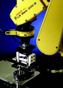

Robotic systems with vision and force sensors "feel" part-feature locations.

"Robotic systems front ended with vision and equipped with force sensors are one of the latest innovations for assembly operations. The vision system guides the robot to properly orient a part, while force sensors essentially 'feel' its feature locations for proper alignment and assembly."
