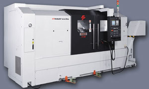

The FEELER FT-Series turning centers have a single-piece structure with boxways, 45-degree slant bed, and solid base, so they are especially sturdy when performing heavy-duty cutting.
“For increased productivity, the new FT-Series design provides customers with exceptional cutting capacity,” according to product manager Paul Hurtig. “Methods’ engineers have incorporated new features for unsurpassed performance and value.”
The FEELER FT-Series includes four models – FT-200, FT-250, FT-350 and FT-350L. For rigidity during heavy-duty cutting, each model has a single-piece structure with boxways, 45-degree slant bed, and ‘robust’ base: FEA analysis is used to ensure a solid machine base with excellent overall structural rigidity and stability.
Additional new design features include a more rigid Z-Axis and tailstock rail for maximum support and accurate tracking. The FT-Series includes a new spindle headstock with a FEELER sleeve-type spindle, and a high-rigidity servo turret including clamping with curvic coupling for stable and swift tool changes. For excellent multitasking capabilities, 7.5-HP milling motor with 51.6 ft/lb torque is provided.
The FEELER FT-Series is driven by FANUC 0i-TD control and 12-station turret. Customers may choose from four different gearboxes and two spindle types. Spindles range from 2,500 rpm to 4,500 rpm and offer chuck diameter sizes from 8 in. (210 mm) up to 15 in. (381 mm). Bar capacity ranges from 2.6 in. (65 mm) to 4.5 in. (115 mm). Maximum turning diameter is offered from 13.0 in. (330 mm) to 25.0 in. (620 mm) and maximum turning length from 21 in. (530 mm) to 60.2 in. (1,530 mm). Machine weight ranges from 9,925 lbs (4,500 kg) to 21,500 lbs (9,750 kg), depending on the model.
A BMT-65 tool system features a solid interface for tool-holding. Servo programmable tailstock is standard. For maximum machine component longevity, a fully enclosed CE cabinet prevents dust and fumes from entering.
