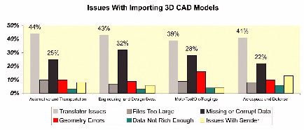

Translator issues were most consistently cited as the biggest problem with getting outside 3D CAD models into the user's CAD system. Missing or corrupt data was the second most often cited problem. The main areas of difficulty are in passing model data between designers using different software, in having to deliver models in different formats to customers and in receiving models in different formats from suppliers.

Kubotek's survey found that 46 percent of all respondents use a parametric feature-based CAD system for their redesign work. Of that group, 87 percent normally have access to the original feature tree, 84 percent regularly need to rework feature trees, and 66 percent indicated that the feature tree usually (more than 50 percent of the time) needed major rework to complete the design task. Only 6 percent of parametric users reported that the original feature tree of the existing or received model always provides the control they need over the model.
Kubotek says: "There is a significant difference between those who use parametric feature-based CAD systems and those who use direct-modeling systems with respect to the need to rework models. Our data indicates that those using parametric feature-based CAD systems have a higher incidence of redesign or rebuilding models from scratch — direct-modeling users do not redesign or rework models as frequently. In fact, 61 percent of direct-modeling users need to rebuild their models less than 25 percent of the time as compared with 43 percent of the parametric users. None of the users of direct-modeling tools reported a regular (three quarters of the time or more) need to redesign models."
