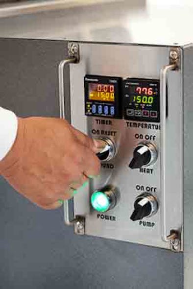

Ultrasonic cleaners operate via sound waves to clean individual parts, a process controlled by a single time and temperature regulation unit.
