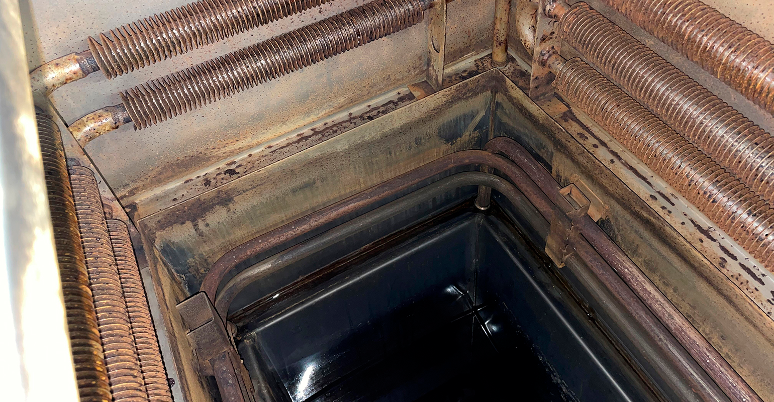

The Switch. The manufacturer decided to replace nPB with a low boiling, more environmentally sustainable cleaning fluid. While the vapor degreaser had no external piping where solvents could linger, and the water separator was a small reservoir on the side, it was still essential to conduct a thorough cleaning process during the conversion. However, the manufacturer did a poor job.
The Consequences: Unfortunately, traces of nPB remained on the coils or in the recesses of the machine. As nPB had a higher boiling point than the replacement fluid, it remained behind as the lower-boiling solvent evaporated. Over time, as the stabilizer in the nPB dissipated, the residual nPB turned acidic, resulting in machine corrosion and compromised the degreaser performance.

During the cleaning process, use soap or a mild, non-scratching scouring powder to clean the degreaser walls and surfaces that encounter solvent. Pay particular attention to removing all rust, especially from the condensate trough and water separator. Avoid using a steel brush or sponge that may scratch or leave embedded particles in the stainless-steel surface.
