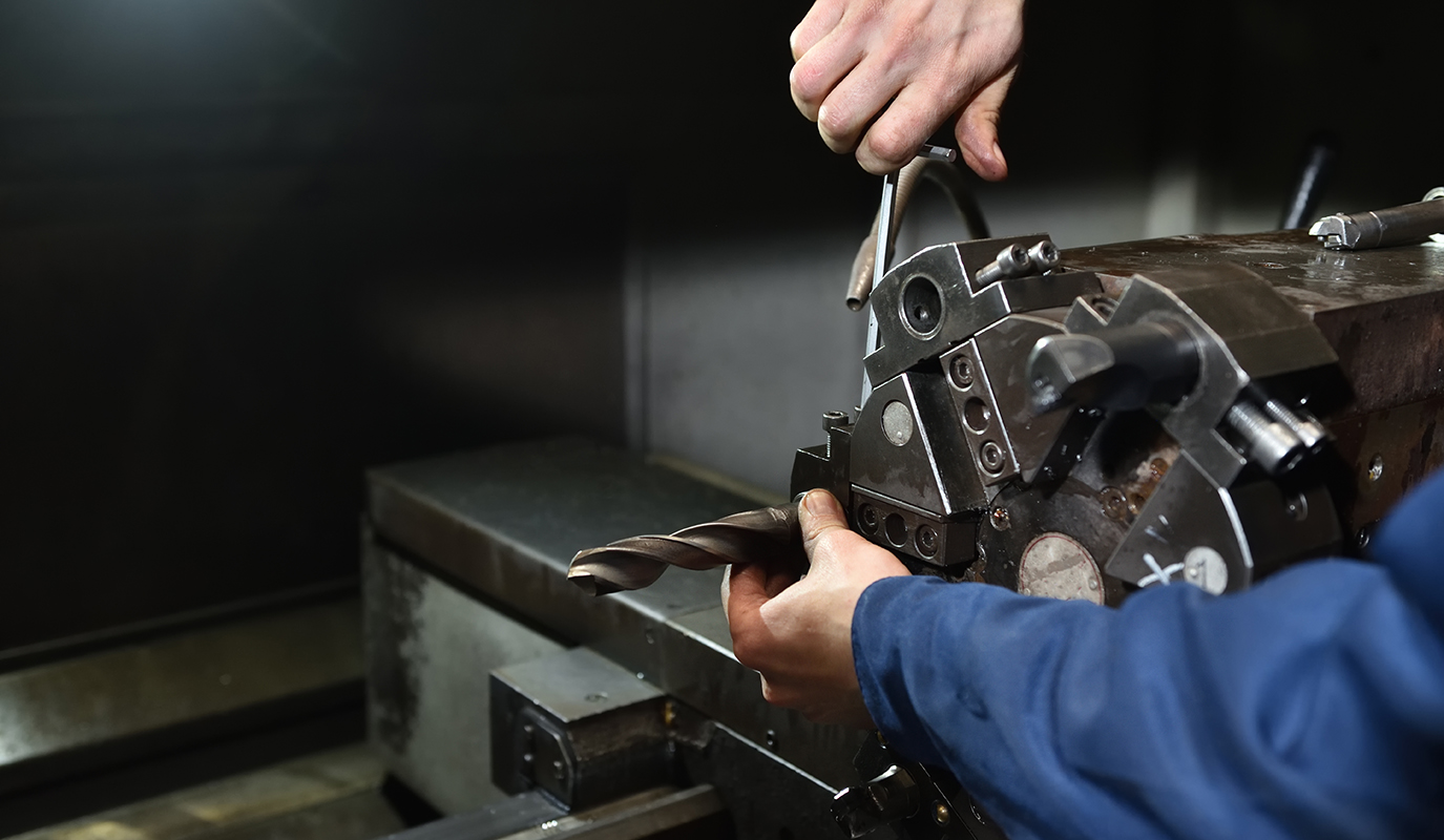

Perform Regular Maintenance
The solution to avoiding machine tool failures is to follow a strict and regular protocol regarding machine maintenance. At a minimum, CNC machine operators should complete the following steps each day:
•  Check fluid levels and top-up;
•  Check all moving parts for dry spots and regrease where necessary;
•  Wipe all surfaces to clear away dust, dirt, and small metal shavings prone to build-up.
Regularly examine the machine. Regular examination of your machine is the best way to avoid catastrophic failures that may result from loose fittings and vibrating parts. This examination should be done weekly, to keep things running tight and smooth.
