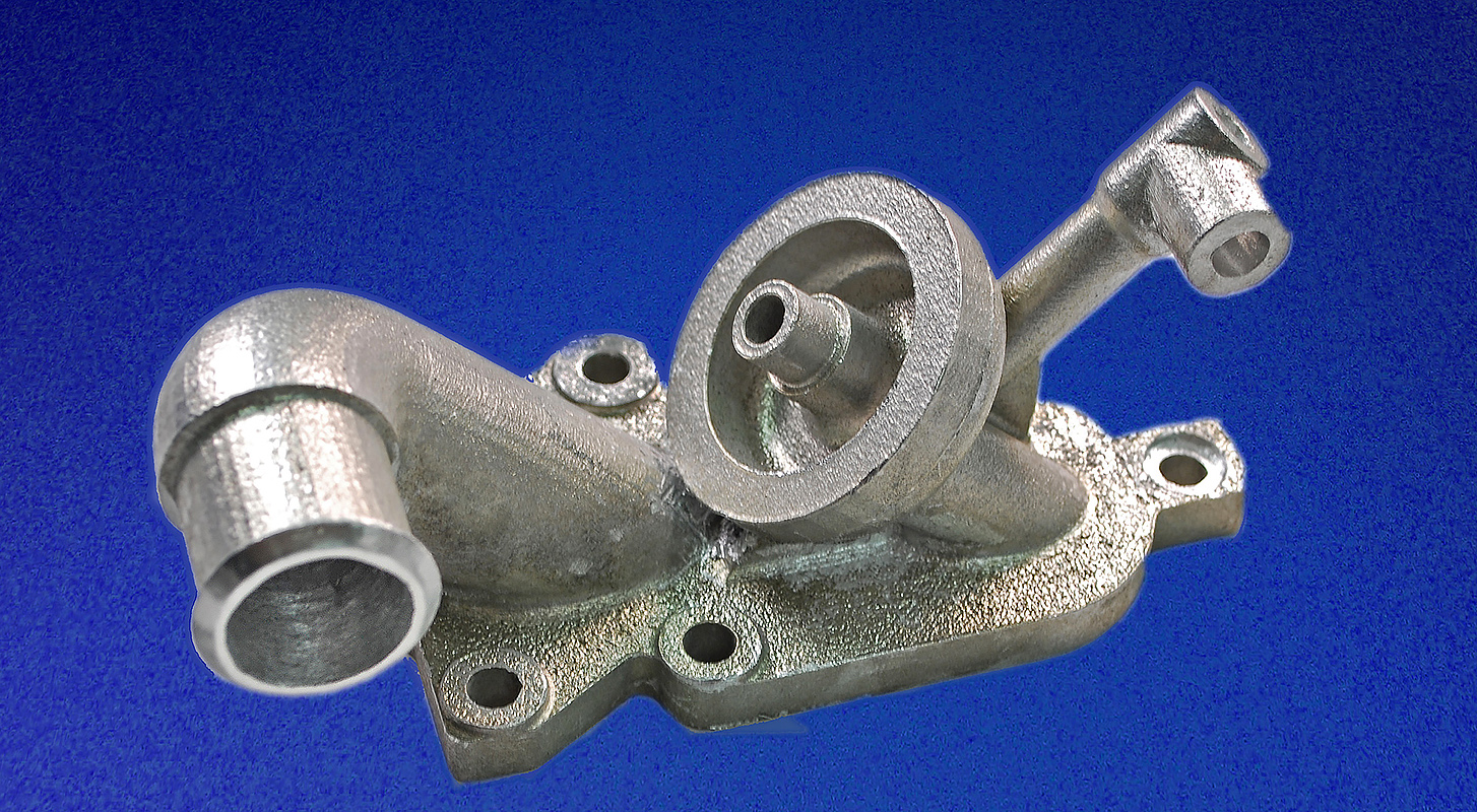

QuesTek HighTemp Aluminum 3DP part
Questek Testing High-Temp Aluminum Alloy for AM

The first powdered aluminum material for 3D printing with no need for heat treatment.
QUESTEK INNOVATIONS LLC has developed a new aluminum alloy for additive manufacturing, capable of high-strength performance at elevated temperatures (200-300°C) in the as-built condition. According to the developer, it is believed to be the first powdered aluminum material to meet those requirements without the need for subsequent heat treatment.
