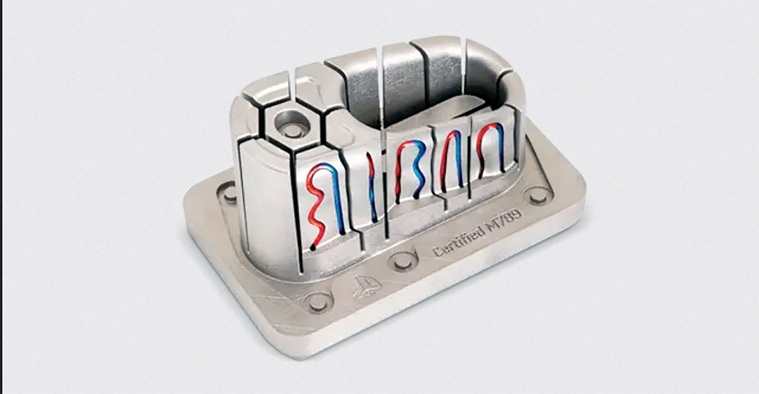

The second new offering is Certified M789 (A), a hardened stainless steel that will be applicable for producing high-strength molds and tooling. 3D Systems attained certification of M789 for its DMP platform through its partnership with machine-tool builder GF Machining Solutions, in response to demand for a hard, corrosion-resistant tooling steel.
Applications for 3D-printed M789 including mold inserts with conformal cooling; drill bits and cutting tools; and automotive drivetrain and axle components. 3D Systems describes the additive-manufactured M789 parts as “optimal for long-term use, able to withstand both the rigors of repetitive manufacturing processes as well as use in regions with high humidity.”
