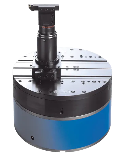

The system backbone. D’Andrea’s modular MHD system is the backbone of the D’Andrea product line. Built around a proprietary, patented connection, each boring head in the system provides the concentricity necessary for high-precision applications. The MHD’s arbors, extenders, reducers, and adapters are shared across its core sizes ranging from the TRM micro-fine boring heads with micrometric radial adjustment to the TRC centesimal fine boring heads for precision finishing, the digital TRE fine boring heads with electronic readout for accurate measurement, and the double-bit TS rough boring heads for aggressive material removal.
Beyond the MHD system, D’Andrea is recognized for its high-precision boring heads, most of which use the same adapters and arbors as those in the MHD system reducing standalone tooling costs across a wide range of machines. For example, the TA-SENSITIV manual heads for boring and facing operations provide reliable and repeatable facing and boring on conventional CNC machines while the AUTORADIAL automatic facing heads execute a complete facing cycle automatically, allowing standard machining centers to complete operations that would otherwise require a turning center or dedicated facing attachment.
An extra machining axis. The TA-CENTER heads add a fully programmable U-axis (radial slide) to any machining center and are compatible with automatic tool change changers. The slide movement is controlled by the machine’s own U-axis output eliminating the need for a separate controller or PLC. Because of this, a machine equipped with a TA-CENTER head can consolidate operations that would otherwise require a dedicated turning center.
Shops working in the aerospace, oil-and-gas, and automotive industries will appreciate that complex internal profiles can be precisely bored in one set-up - and that the head is stored in the tool magazine much like all other tools in their inventory.
For machines without an automatic tool changer, the TA-TRONIC heads feature a motor integrated into the head body itself. The motor then connects to the machine’s U-axis numerical control making the head fully programmable for all radial positioning moves.
When a standard boring bar simply cannot reach the large-diameter precision boring and facing process at hand, the U-TRONIC large-format NC heads fit the bill. Connected to a machine’s U-axis for precision radial slide control, the U-TRONIC line ranges from 360 to 1000 mm in diameter, and special versions are available to 1600 mm with an internal coolant passage to bore through even the toughest materials.
These heads can be mounted manually, automatically, or via palletized tool change systems.

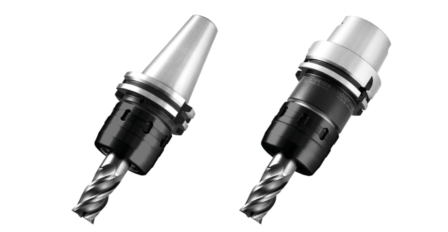

Further, the MONOFORCE high-precision ultra-tight toolholders offer high-gripping for demanding milling operations where conventional ER collet holders are insufficient. For aggressive roughing cycles or high-torque finishing on difficult materials, these toolholders are compatible with a variety of spindles across a mixed machine shop floor.
Rounding out the D’Andrea toolholder line are the MONOd single-body integral collet chuck line and the THT turning modular toolholders for stationary tool turning operations on large machining centers and horizontal boring mills.
