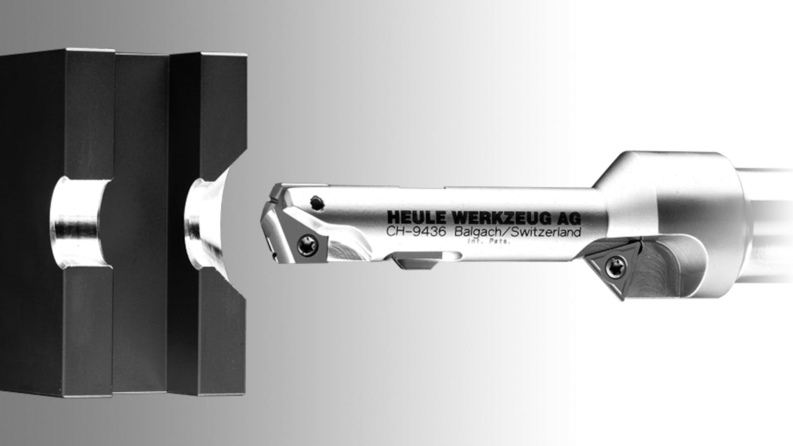

According to Huele, the tools can chamfer and deburr holes while in the process of milling.
Huele Precision Tools announced the launch of its COMBI brand tooling line on January 26. According to Huele, COMBI tooling bits can be used to perform a variety of operations without changing the tool in use, including drilling chamfering, countersinking and sometimes spotfacing. The company anticipates the tools will be useful for precision, high-volume applications, including for work involving heavy and automotive equipment.
The device works using a standard spade drill and a SNAP chamfer blade for drilled holes that are chamfered and deburred in the process of milling. The COMBI tooling line is available in sizes from 35 to 9.5 millimeters, are available with optional through-cooling or in various lengths.
