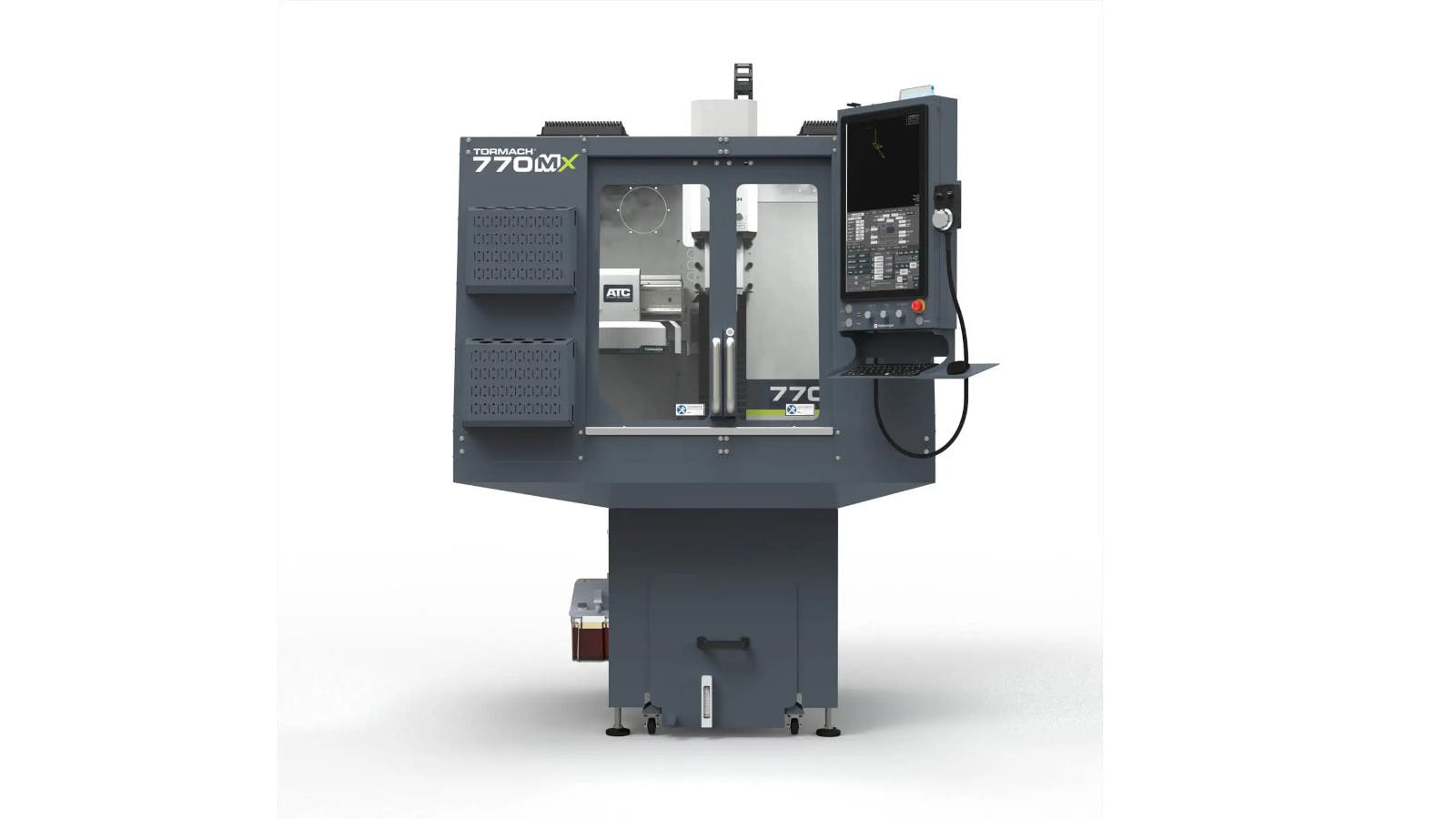

Tormach announced it had launched a new version of its 770MX CNC mill January 23. In a release, the CNC and automation manufacturer said the latest 770MX CNC mill improved on previous versions in terms of power, faster motion, faster feed rates and reduced cycle times. The device also includes an EtherCAT-compatible servo motion system and a control platform for the spindle and axes. The spindle can provide 2hp of continuous power and 4.5hp peak intermittent power.
Despite the upgrades, the new model features the same size as previous versions, with a working envelope of 14 inches X by 7.5 inches Y and 13.25 inches Z. Feed rates for the new mill can reach 450 IPM in the X and Y axes and 420 IPM in the Z.
Usability additions to the 770MX include a 21.5 inch touchscreen operator console, built-in load meters for the spindle and axes, an integrated air gun on the front of the enclosure, an included door latch, improved side-loading windows and mounting locations for tool holder racks.
