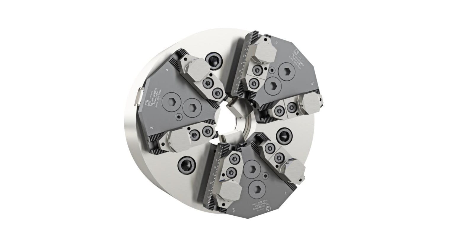

On the turning side, visitors will have the opportunity to see the company’s unique INOLine clamping system. This includes INOFlex 4-jaw chucks that use a unique design that allows each set of jaws to operate independently to achieve secure clamping of round, rectangular and asymmetrical parts.
