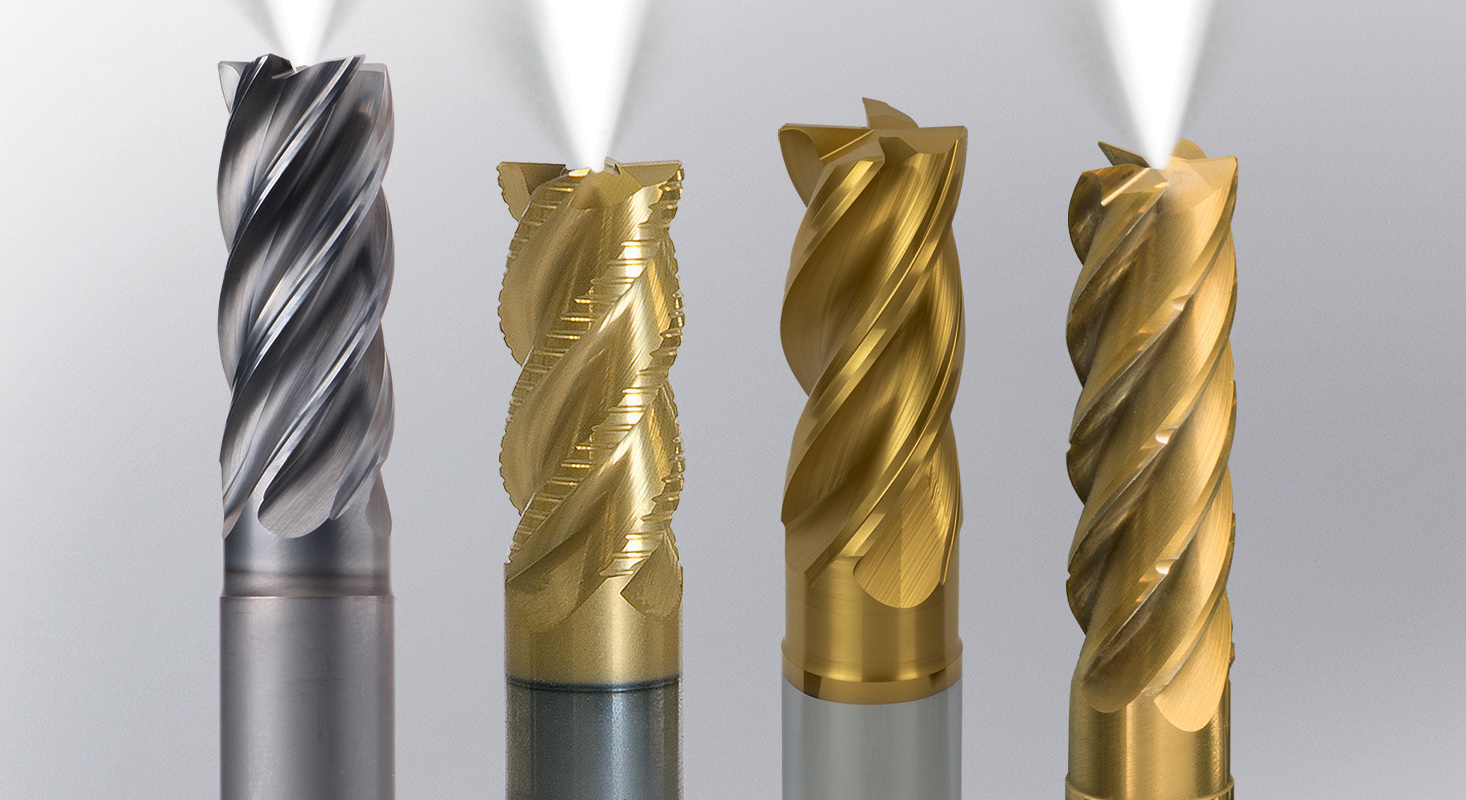

EMUGE CORP. expanded its Emuge-Franken TiNox-Cut End Mill line, designed for high-performance machining of demanding materials such as Inconel/nickel alloys, titanium and stainless steel found in aerospace and other challenging applications. Four TiNox-Cut End Mill series are offered now, including the new 5-Flute N, NF, Base, and Trochoidal tools.
-  5-Flute TiNox-Cut N:  This new coolant-fed series features five flutes for high feed rates, a raised land that increases chip clearance, and it is ALCR-coated. It is a high-performance tool designed for roughing and finishing, especially suitable for materials such as titanium and titanium alloys.
-  TiNox-Cut NF:  This high-performance series features a fine chip-breaker design that reduces chip size while reducing cutting forces. The tool features a proprietary TiN/ TiALN coating in both coolant-fed and solid designs, for semi-finishing difficult materials such as nickel alloys.
-  TiNox-Cut Base:  The Base design is a material-specific style tool with a proprietary TiN / TiALN coating for roughing and finishing, for stainless and acid-resistant steels.
-  TiNox-Cut Trochoidal:  Ideal for high metal-removal rates, this tool series features a newly developed geometry, a proprietary TiN / TiALN coating and a chip breaker edge, which combined, reduces stress and vibration when machining difficult materials such as titanium and stainless steel. All tools are coolant-fed for maximum performance. Designed for trochoidal milling via the overlapping movement of circular paths, these tools can rough and finish mill over 30% faster than standard designs, while increasing tool life significantly.
Emuge-Franken TiNox-Cut End Mills are made from premium ultra-fine, micro-grain solid carbide with a maximized transverse rupture strength for high-impact applications, and produce impressive results compared to conventional end mills. Advanced PVD-applied multi-layered coatings withstand excessive heat and provide superb wear resistance for longer tool life, and tool geometry is designed to produce minimal vibration when machining tough materials.
TiNox-Cut N, NF, and Trochoidal End Mills are available in axial internal coolant-through capability for maximum chip evacuation and cooling ability. TiNox-Cut N and TiNox-Cut Trochoidal tools are available in both square-end and corner radius configurations. Weldon flat-shank construction is available in both TiNox-Cut NF and TiNox-Cut Trochoidal tools and is compatible with Emuge FPC Milling Chucks featuring an anti-pullout pin lock system.
Overall, the expanded line includes tools that are available in inch sizes ranging from 0.25 to 1 inch in diameter, and in stub, standard, long, and extra-long lengths.
