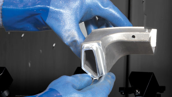

With high-performance machining capabilities in-house, Alumalloy is also able to use secondary machining as a quality assurance process for its foundry. Now, the company identifies exactly when and where any true quality issues arise and moves to resolve them before parts are shipped.
For a company originally centered on making aluminum parts with a single casting method, the makeover is remarkable. Alumalloy offers complete casting and secondary machining, ensuring consistent high quality and on-time delivery.
Alumalloy’s customers seek this start-to-finish capability across a wide range of part types and sizes. For Volvo, Alumalloy makes various engine and transmission parts and completes some subassemblies for its customers’ Volvo and Mack trucks. For General Motors, it makes safety-critical suspension sway bars, along with windshield corner brackets for the Chevrolet Corvette.
“We can offer the customer a full part that they can put on their vehicle. Without that, we’d be a quarter of the size we are today,” Daniels said.
Daniels and company control the quality of every part, from pouring to machining to subassembly, as needed. The capabilities Alumalloy offers from raw materials to finished parts set the company apart from competitors offering only foundry or just machining services. Alumalloy has even won back 18 parts orders that had gone to competitors in China. “Some of the customers we get now will only entertain a bid because we can do everything under one roof,” Daniels said.
