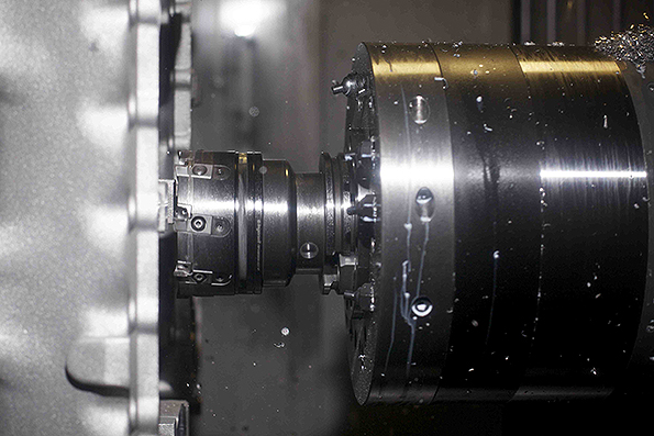

Roughing in progress. Despite interrupted cuts, the new Ingersoll-TEDI mill CD cartridge facemill plows through cast aluminum twice as fast as ICI tooling.

A 6-in. Ingersoll-TEDI mill PCD cartridge cutter finishes a crankcase surface at 8,000 RPM and 300 IPM – four times faster than the shop’s previous PCD cartridge cutter had done, and with better finish and flatness. Rated at 20,000 RPM, the new facemill features extra rigid clamping, coolant aimed directly at the cutting edge, positive rake presentation geometry, and easy axial cartridge adjustment to 2 microns.
