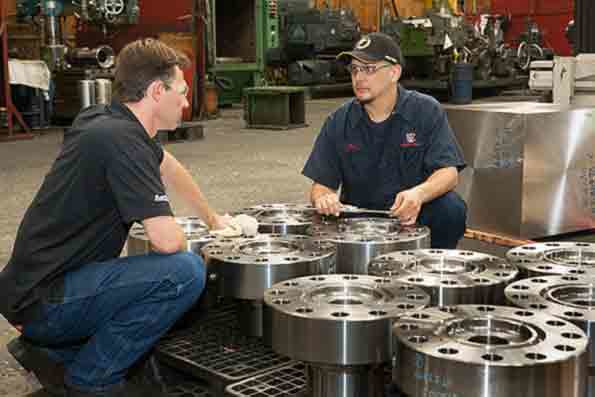

Now the big chips peel off in easily controlled “sixes and nines,” reducing a 480-lb. billet of 4130 steel to a 250-lb. valve bonnet in about 45 minutes on a Doosan 400LM turning center. The job used to take up to two hours to complete – and usually shattered one tool per part.
The retooling began when Jim Beaver set a new tool-life requirement for the operation: two pieces per edge, minimum. The standard insert at the time, an older conventional CNMG negative-rake tool, rarely lasted through one part.

CNC lead man Ben Molinar ran the test on live parts, on site, with Ingersoll guidance: heavy OD roughing, OD finishing, and facing on 4130. (A comparison of the results appears in Figure 1.)Once the tool proved out operationally at the parameters established in the test, Beaver did some fine-tuning. He eliminated the two back-up tools from the turret and ramped up the depth of cut to 0.325 in. for turning and 0.225 in. for facing. Still, the inserts lasted through at least two parts with absolutely no ruptures. “Now the failure mechanism is gradual wear, not fracture, and the indicator for edge change is simply loss of finish,” said Jim Beaver.
