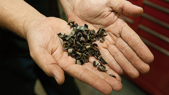

The heavy-duty turning operation at AWC Frac Valve now reduces a 400-lb billet of 4130 steel to a 250-lb valve bonnet in 45 minutes. The OD turning and facing operations, which threw off chips the size of cornflakes, used to take up to two hours. With breakthrough Ingersoll CNMX insert, it’s now done in 45 minutes.
The new tool is Ingersoll Cutting Tools’ CNMX Gold Duty, a very advanced indexable coated carbide insert.  With radically aggressive top-face geometry, in an advanced seat pocket scheme, it is a generation ahead of the field in large-scale turning, according to Ed Woksa, Ingersoll national turning product manager.  AWS is one of the first users of the new insert, he added.
Now the big chips peel off in easily controlled “sixes and nines,” reducing a 480-lb billet of 4130 steel to a 250-lb valve bonnet in about 45 minutes on a Doosan 400LM turning center. The job used to take 105 to 120 minutes – and usually shattered one tool per part.

“You can see the big wide front edge that really breaks up the chips on a pretty gummy metal,” said Jim Beaver.
