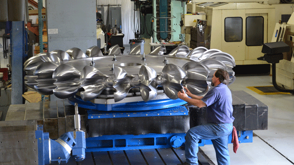

A hydropower ldquorunnerrdquo in process at Canyon Hydrorsquos automated CNC facility in Sumas Wash mdash a shop that runs 24 hoursday every day Completing one runner is a five axis job that takes months and produces one and a half ton of chips The bulk of machining is handled with standard 2inch indexable ball mills but critical undercuts are completed with a modified standard Ingersoll button mill that makes chips on the way in and also on the way out

In a virtually unmanned, five-axis CNC operation in Sumas, Wash., Canyon Hydro contour mills the buckets in 10-ton hydropower turbine rotors in half the time as before, using a modified Ingersoll button cutter that cuts as it retracts as well as when it advances.  Previously, the undercutting required a separate operation on a separate spindle.  The inserts are standard, only the cutter body was modified to accommodate additional inserts for the undercut.

The long-reach aspect of the Canyon Hydro job is evident here.
Canyon Hydro mounted a modified standard Ingersoll button cutter on a 19-inch extension, Sometimes working like a T-slotter, it a accomplishes a long-reach cutting task and eliminates the need to involve a separate spindle

Canyon Hydro’s key machining challenge is to contour mill the buckets on ten-ton hydropower turbine rotors, called “runners.”  Completing a runner typically takes months of continuous five-axis, long-reach milling, much of it undercuts, leaving behind a ton and a half of chips.  Virtually all the milling is done on 19-inch shank extensions.  Nevertheless final surfaces must be smoother than 32µ and dimensionally correct within 0.010 inch.
“Cycle time savings are really secondary to repeatable accuracy in an unattended environment,” said Canyon Hydro manufacturing engineer Mike Hansen.
Hansen specified standard tools in his RFPs, but most vendors proposed a palette of specials anyway, and asked for up-front development money.  The only exception was Ingersoll, which proposed a 2-inch ball mill for 90% or the milling, and a modified standard Form Master button cutter for the undercuts.  The only modification is to add inserts on the backside of the cutter body to handle those undercuts.  The cutter works like a standard button cutter most of the time, and then like a T-slotter when it reaches the undercut portion along the outer edge of each bucket.
Hansen runs the cutters at full speed during the day when the place is manned, and backs off the feed about 10% during the unmanned shifts as a precaution.  In all cases the inserts last long enough for absolute process security for 12-15 hours at full speed; some last 45 hours in the cut per edge.
