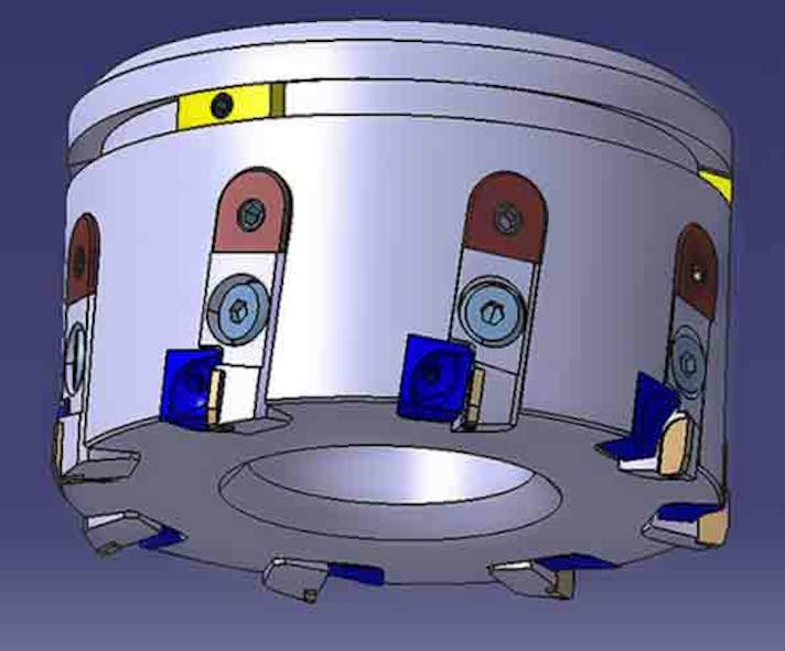

This sketch of the PCD TediMill details the coolant nozzles in the (blue) clamping wedges, two-way clamping (light blue Allen set screw, dark blue wedge) and extremely strong, dynamically balanced cutter body. Cutters are certified for 16,000 SFM service right out of the box. Early users report faster throughput, cooler running and finer finishes compared with competitive PCD cartridge mills.
There are three design details promoting this higher level of performance by the Ingersoll TediMill — details not found in any other aluminum facemill, whether PCD or ICI: extremely rigid cartridge seating; positive rake presentation; and through-tool coolant direct to the cutting zone.  The tool comes with a level of dynamic balance that qualifies for 16,000 SFM cutting speeds right out of the box, leading to the chatter-free 3.2 µ finishes as well. In fact, the TediMill tools have run at 54,000 RPM vibration-and chatter-free in independent tests on the fastest spindle in the world.  So, by ISO standards that particular cutter can be rated to run as high as 27,000 RPM in production environments.

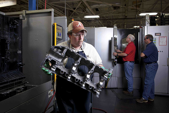

Continental’s retooling began during a regular plant walk-through with Ingersoll’s Bruce Burroughs, to resolve a problem with overheating.  On larger crankcases, machining heated the workpieces so much that the operation had to be stopped midway through each part for reclamping, to relieve machining stresses and eliminate part distortion.  The tool in use was a mainstream 6-in. PCD, zero-rake cartridge cutter.

Trials were conducted on Continental’s Toyoda FH630SX horizontal CNC, both to validate the new tool and to establish machining parameters for operational use.  Here are the highlights:
In fact, Continental reduced the feeds and cutting speeds back a little when going operational.  “This was precautionary, to protect the spindle on a light-frame machine, not for any limitation with the tool,” Continental manufacturing engineer Mike Brown explained.  One of the machinists in the shop, who once worked for a machine rebuilder and had seen a lot of spindle damage, had warned Brown about the danger.
He ramped up to the trial parameters very shortly, and the operation has run without incident ever since then.  Removal rates for roughing are up by 4-to-1 over the previous ICI cutter; for finishing, the gain is 2-to-1 over the previous PCD cutter.  Flatness and finish are improved as well.  Stoppages and reclampings are a thing of the past.  As a result, Continental also has retooled roughing operations on other parts with a 4-in. TediMill taking 0.090-in. depths of cut, and it reports a doubling of throughput versus an ICI tool.

Unlike all other PCD cartridge mills, the Ingersoll TediMill features absolutely rigid cartridge seating, positive-rake presentation, and coolant delivery directly to the cutting edge (see Figure 1.)  The cartridge is clamped to stop movement in one direction and wedged to stop movement in the other.  The cartridge has smooth, precise, simple axial adjustment to 2 microns, to optimize balance in spindles running at 20,000 or above.  Insert corner radii are replaced by small, 45-degree chamfers to reduce axial cutting forces.  The cutters also are dynamically balanced to meet 16,000 SFM ratings right out of the box, and have withstood 54,000 RPM in independent tests.
