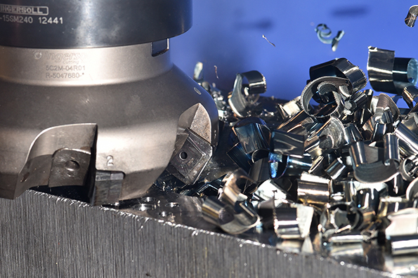

Early field experience milling large, nasty castings and forgings indicates that negative/positive cutters can materially raise the removal rate, double edge life, and put an end to catastrophic insert failure that stalls production and can damage the workpiece in large-scale work. The experience covers facing long, abrasive 15-5 forgings that weigh tons, refurbishing big forging dies in tempered FX, and cubing 20-foot manganese steel railway castings.
The cutters making the difference are heavy-duty Ingersoll Cougar-Mill facemills with Power-Shear inserts, only lately commercialized.  Besides the negative/positive cutting geometry, the cutters feature improved, wedge-type seating that mechanically locks the inserts in place to better withstand heavy cutting loads.  The cutters are available in standard diameters up to 14 inches.

Die refurbishing — A Davenport, Iowa, mold shop reported 70% higher throughput and double the edge life when re-facing worn forging dies in hardened FX steel (Rc 38-42). The interrupted cuts in such hard stock make the application especially punishing on both tooling and machine. Accordingly, the operation is run on a very rigid boxed-way 30-HP gearhead vertical mill.
The previous practice was to use double-side button or square inserts in 4-inch cutters and to run no faster than 420 SFM, 14.5 IPM feed (0.006 advance/tooth [APT]) and 0.150-in. depth of cut (DOC.)  Raising either parameter in any combination caused unacceptable shock to the machine and catastrophic insert failure.  With a 4-inch Cougar-Mill cutter body and Power-Shear heavy-duty inserts, the shop now feeds 25% faster and 66% deeper.  Standard parameters now are 420 SFM, 19.2 IPM (0.008 in. APT) and 0.250 in. DOC.
Now, the principal failure mode is flank wear, with only minor chipping.  “At the heart of this particular success,” explained Ingersoll product manager Don Yordy,” is the thickness and strength of the insert cross section coupled with a free-cutting axial rake geometry.  The result is smoother chip formation and entry, even through interrupted cuts as the tool passes over the dies’ impressions.  The bottom line is higher feed rates, deeper cuts and longer edge life.
