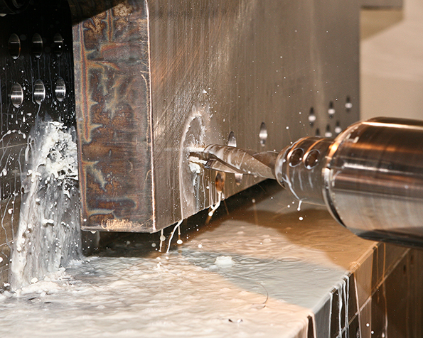

With the tooling and extension they were accustomed to using, the fastest they could feed at the bottom of an 18-in. cavity in the hardened mold stock was 50 IPM, and still they
were plagued with chatter and ruptured inserts. They had to limit deep-hole drilling penetration rates to 5 IPM for the same reasons.

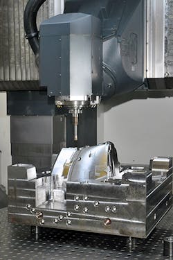

A Redoe Mold operator assembles Ingersoll Inno-Fit extension shank to mill bottom of deep mold cavity. For extra rigidity, coupling features three point contact, self-centering design and large contact area at mating surfaces.
With the switch to Ingersoll’s Inno-Fit extra rigid shank extension, Redoe now feeds at full speed all the way to the very bottom of the design. Feed rates for milling are five times faster, with twice the edge life and no sudden rupture. Penetration rates for 8:1-aspect holes have tripled to 12-18 IPM. “We’re milling at the bottom about as fast as we do on the surface with a stubby tool,” said lead machinist Jay Noble.

Cycle times for semi-finishing dropped dramatically at Reko Mold Ltd. when Ingersoll Hi-Feed Mini replaced standard ‘high-feed’ button cutters on a newly acquired five-axis DMG 210 mill. The tool feeds at 900 IPM in hardened P20 mold stock, through the corners as well as down the straightaways. The tool literally doubled capacity of the new machine, according to Reko lead machinist Jay Noble. “Tooling deficits in ‘high-feed’ button cutters may not impair two-axis processing but become painfully obvious in five-axis work,” he said.
Also contributing to these rates are free-cutting tools that resolve cutting forces more axially than laterally. Rough milling is done with the new Hi-Feed Mini at 400 IPM and 0.030 in. depth of cut (DOC).  Ingersoll Form-Master V facemills do the finishing passes at the same feed rate with lower DOC. Drilling, on deep holes up to 2-in. diam., is done with Ingersoll Quik-Twist indexable drills on Inno-Fit shanks.
