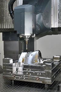

Roughing Deep Cavities — Up in Canada, two mold shops that once relied on standard button cutters to rough machine 18- to 22-inch mold and mold cavities have sped that process up by at least 2 to 1. What made the difference in both plants is an advanced, IC face mill with unique insert geometries, mounted on extra rigid extension shanks.
The inserts on the Ingersoll H-Feed Mini mill look like rectangles with radiused ends, enabling a smaller cutter to go full speed through the straightaways and deeper into corners than a larger tool can do. The extra-rigid carbide Inno-Fit extensions feature a self-centering, three-point coupling design and large-surface contact area between segments. Feed rates average 400-900 IPM depending on tool diameter, versus the previous 50-100 IPM respectively.
Said Tom Hunt, manufacturing supervisor at Reko Manufacturing Group, Windsor, Ont., “We do the cavity work on five-axis machines, where the tooling deficits inherent in button cutters become painfully obvious. We had to slow down in the corners before, but not at all anymore.”
Lead machinist Jay Noble at Redoe Mold, also in Windsor, said, “We’re milling at the bottom of a cavity as fast as we would with a stubby tool on a surface cut.”

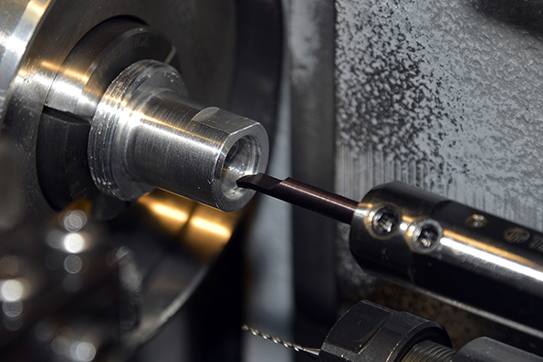

Deep Boring — In bores of any depth, cutting conditions are apt to deteriorate because there’s rarely enough room for both a sturdy tool shank and decent chip evacuation. As a result, tool selection necessarily becomes a compromise. Besides this, the machined surface is concave, which complicates formation of free-flowing chips.
However, a new boring tool with an elliptical shank and high-shear cutting edge, called the Ingersoll T-Micro system, eliminates the compromise. The long axis of the boring bar lines up with the main cutting forces, enhancing rigidity in deep-hole work. The short axis expands the chip-clearance areas.
A telling example of this principle at work shows up on a very challenging deep boring job on a tiny medical part made at Medfab Manufacturing, Lakeville, MN. “Titanium tubing, 4:1 aspect ratio, walls thinner than a fingernail, close tolerances, and a 20µ finish requirement on the entire ID: that makes for a ‘perfect storm’ of machining headaches,” the production engineer said.
With all previous tooling schemes, the boring operation took three and a half minutes per part, at best, always followed by 15 minutes of hand polishing. Moreover, the as-machined finish deteriorated so quickly as to require tip replacement every 30 pc.
By contrast, T-Micro tool completes the part in less than three minutes and leaves an 8- to 10-µ as-machined finish, which needs no hand polishing whatsoever. And, the tip lasts through at least 250 pc.
