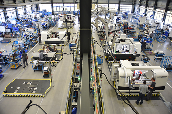

But perfected production process can be more than simulations. Recently, the United Grinding enterprise commissioned a new Flow-Assembly+ process at its Studer factory in Thun, Switzerland. The reconfigured production system incorporates all manufacturing operations for the entire Studer product portfolio into one assembly line, which the machine tool builder noted is improving its ability to meet specific customer demands and delivery requirements quickly and efficiently.

The Flow-Assembly+ process divides assembly for Studer internal and external cylindrical grinding machine into 16 stations, which are arranged as a U shape within the workspace. On one side of the U, a normal rail system is used. On the opposite side, where laser measurement and test grinding of the machine in motion takes place, there is a high-precision conveyor system that is approximately 130 feet long, corresponding to a large, high-precision machine tool guide.
The 16 stations are divided into four segments: in each segment, up to four employees per station assemble the complex Studer machines.
The line is designed to operate with a single shift of two, four-hour sessions, and during each four-hour sequence the process runs continuously at a speed of 1.375 miles per hour.
Currently, line is set up to produce two machines per day, but according to United Grinding the system is sufficiently flexible to increase output as demand grows.
With Flow-Assembly+, machines are ready for delivery to customers once they have passed the final station in the line. Design modifications, such as special in-process gauging systems or customer-specific clamping systems, as well as laser measurement and test grinding, are integrated into the flow.
To enhance productivity, the numerous component parts required to assemble the machines are delivered to the line “just in time directly,” from a warehouse, partly adopting a Kanban system: Every four hours, material is delivered for the next four hours, including the provision of all necessary parts and tools.
Prior to the Flow-Assembly+ installation, the Studer assembly plant used fixed-station and non-continuous paced assembly process.
The new process at was completed in three and a half years and represents a result of United Grinding’s PuLs® continuous development and improvement program — adopted eight years ago to streamline all processes and operations, to improve efficiency.
