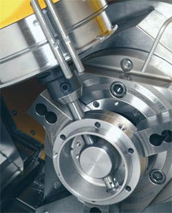

For long-reach limited clearance applications, consider using a solid carbide bar instead of multiple extensions. This set-up offers higher rigidity and better control, but is generally limited to smaller diameter bores.

(Opposite page) Tooling for an extended reach bore where only the gage length and bore diameter are considered (Fig. 1) lacks the rigidity of a modular system that uses a larger connection size for reach and only reducing the tool diameter when necessary (Fig. 2).

Often, boring tools are selected for an application based on a required bore diameter and gage length, without consideration for the actual boring depth and the extra reach required, if any. For example, an application may require 8 in. of reach through the part and/or fixture just to get to the bore, and only 2 in. of boring depth. This is quite different than an application that requires a boring depth of 10 in.
Modular tooling systems offer an infinite number of combinations for maximum rigidity and usage. In cases where tool length is needed, it is important to start with a larger base size and then reduce the tool diameter as necessary, rather than using the same bar diameter for the entire length of the tool.
