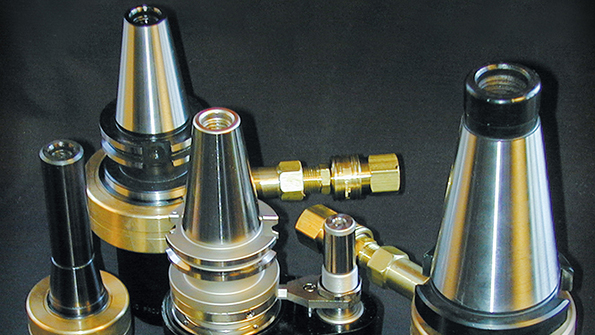

Although coolant-induced toolholders are commercially available, they can be quite expensive. Collis offers more affordable options, for toolholders that induce a side flow of coolant through the collar.

Coolant-induced toolholders — Machining centers designed for through-spindle coolant application have been standard for years.  When used in boring or tapping operations with hollow cutting tools, excess metal scrap and shavings must be flushed from holes and bores.
However, when there is no provision for feeding coolant through the machine spindle, there are alternatives where coolant can be introduced through the collar of the toolholder.  This not only minimizes overheating and distortion of the workpiece, it also greatly extends tool life.
Although coolant-induced toolholders are commercially available, they can be quite expensive.  Fortunately, there are options that cost much less – in the several hundred-dollar range – from manufacturers like Collis for Cat V-Flange, BT, NMTB, Morse Taper and R8 style shanks.
