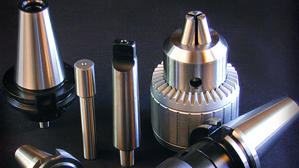

For many machinists, the conversation begins, “If I could have this size tool with this attachment on it, we'd be able to …”. With the variety of machine taper types, sizes, differences in the flanges, draw-in thread sizes, and pull studs, finding the ideal toolholder for the job can be a difficult task.
Yet in many cases, if machinists want to make adjustments in dimensions, quick-change tooling or other options can reduce set-up times and speed production of machined components. This can be as simple as extending the tool length so the path of travel to the workpiece is minimized, or setting up all tools for quick change-outs.
Inevitably this leads to long, exhaustive searches of catalogs or online forums. Failing to find what they need, some machinists purchase ‘blanks’ and grind them down to meet the precise requirements of their operation.
However, some manufacturers, particularly smaller, more nimble, U.S.-based operations, are willing to create specialty toolholders.

According to Gassman, just about any toolholder can be produced based on special requirements or proprietary dimensions, in just about any combination of shank, collar, and collet. Furthermore, just about any system can be converted into a quick-tool-change format. Adjustable adapter and tap extensions are also available.
This can be a simple matter of mixing and matching options already in a catalogue. If an appropriate toolholder cannot be located, a replacement can be machined by those with the in-house capability using CAD software to adjust for varying projection lengths.
“You can basically combine any shank and holder together and extend the dimensions in any direction, and our software program will recover all the dimensions on the tool so it isn't like drawing everything from scratch,” Gassman said.
Quality domestic manufacturers also have more expertise achieving the precise tolerances for optimal fit and concentricity. By using options with superior fit and better balance, more accurate work and better surface finishes can be achieved while extending the life of the equipment itself.
For all its tapered toolholders, Collis is known for exceeding the industry “AT” standards for precise fit in the spindle. These standards are a specification of ANSI/ASME standard (ASME B5.50-2009), and indicate the tolerances that must be met in relation to the taper angle. Collis uses one-half the allowable tolerance of this standard.
For high-speed machining above 10,000 RPM, the toolholder also must be balanced more precisely or vibration can occur, leading to out-of-tolerance parts. For these reasons, Collis machine-tool spindles and machine-tool parts usually are specified with vibration levels of G2.5, whereas others offer only G6.3. Although the toolholders are custom manufactured, Gassman said this does not have to mean long lead-times.
