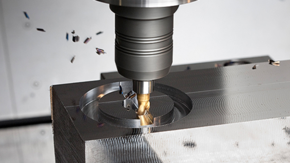

The new MS2050 is produced with an advanced coating technique and substrate that enhances process reliability and establishes higher cutting data to applications involving titanium alloys.
Milling — Seco will spotlight several milling insert grades, including the new MS2050 that’s produced with an advanced coating technique and substrate to enhance process reliability and establish higher cutting data to applications involving titanium alloys. The special PVD coating on the MS2050 not only strengthens the insert’s wear resistance, the cutting tool developer explained, but it also eliminates reaction with the workpiece material, increased cutting speeds and tool life and a lower cost per part. MS2050 is available in several positive geometries for square shoulder milling, face milling, copy milling and high-feed milling.

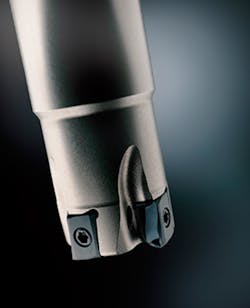

Made for roughing and semi-finishing, the new Square T4-08 brings smooth cutting action and good surface finish to slotting and contouring applications.
With its four cutting edges and novel cutter design, the new Square T4-08 shoulder milling device balances economy and performance when machining cast iron and steel. Made for roughing and semi-finishing, the Square T4-08 brings smooth cutting action and good surface finish to slotting and contouring applications. The tangential mounting of the tool’s inserts increases the surface area of contact between the inserts and cutter body, resulting in increased rigidity and machining stability. The mounting design also directs the cutting forces to the thickest part of the inserts, so the milling performance is robust and the metal removal rates increase, with small diameters.
