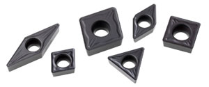

Seco Tools’ M5 insert design involves a well-protected chip groove that helps machinists complete demanding tasks and rough materials without interruptions, and an open chip groove with well-adapted cutting angles that promotes high feed rates and large cuts.

For example, Seco Tools offers a new positive-lock chip-breaker insert — the M5 — that’s designed for strength and longevity in turning and boring applications. The developer said the M5 optimizes tool life for machining a wide range of materials and applications thanks to a balanced rake face that minimizes the heat transferred to the insert. It’s particularly recommended for jobs with steel, stainless steel, cast iron and superalloys, including roughing as well as semi-finishing steps.
Seco Tools said the M5 is offered in a variety of grades, such as TP40, TP0500, TP1500, TP2500, TP3500, TM4000, CP500, TK1001 and TK2001 and is effective on various categories of high-value automotive components, including transmission parts, cylinder blocks, hubs, flanges and shafts.
The M5 design involves a well-protected chip groove that helps machinists address demanding tasks, heavy interruptions, and rough material layers, while an open chip groove with well-adapted cutting angles ensures high feed rates and large cuts. The combined effects promote more efficient machining and greater economy for the shop. In addition, Seco indicates that the fine-tuned chip groove provides full control while handling ductile materials.
Also, it can be paired with Seco’s Jetstream Tooling™ system that delivers coolant to an optimal position close to the cutting edge. The jet of coolant lifts the chip away from the rake face, thereby improving chip control and tool life as well as allowing for increased speeds and feeds.
