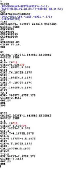

Example 5 shows the front end of SUB macro.
I simply enter parts per cycle as well as stations I need to rotate the code. This is done when using double vises where the rear position usually has the X stop used for both, which means that the rear vise is locating the part on the wrong side unless the part is turned 180 degrees.
Generally, if this is a first operation from oversize stock
this doesn’t really matter, but if it’s a subsequent operation where the datums now have been created, it could cause problems.
Example 6 shows the proven code and Example 7 shows the code for running the job on two double vises on a subsequent operation.
In example 6 you see the posted output for tool 1, and in Example 7 you see the reposted format.
Because all the repost does is apply the original
G-code from the proven file and transpose it into a multiple part file, there is no reason to fear a loss in translation. As you can see, two separate subroutines have been created by the post. The O1 is used where the part is positioned with the stop on the left, and O199 is used for the position where the stop is on the opposite side and the code is rotated 180 degrees.
All this is all done internally, and all the user needs to do is fill in the parameters. The average person could learn its use in less than five minutes. Then, using Inplot or any system that reads toolpaths, it’s possible to verify the new output.
