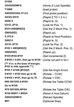

The macro for the probing was straightforward. The logic is to probe the two ends of the piece called for on the print using the Y value programmed as the base, and the difference of the Z distances to calculate the angle of misalignment using trig in the macro. Then, have the macro reposition the polar axis and reset its datum. Now, this sequence took less than 30 seconds and was accurate to arc seconds.
Below is the macro code that would be used on a Fanuc type control. (See Table 1.) Writing for other controls is usually not too different from this. For this example, the distance in the Y axis to probe is 4 inches and the angular error of the fixture is assumed to be less than a few degrees since the fixture would ensure this. The X, Y datum is the centerline of the part; Z datum is the top surface of the fixture when aligned. The centerline of the rotary table is along the X-axis. Clockwise rotation is positive and counter clockwise negative.
Of course, the macro needs to be proven. It has been a while and I composed this from memory. I am 99 percent sure it is accurate — and never would be 100% sure until I prove the macro on the machine. An extra pass also should be added to the script via a loop routine, or simple cut and paste, to ensure that the adjustment is correct.
