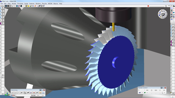

•  Two 5-axis multi-blade options. These options will simplify programming and machining for bladed turbo-machinery components such as impellers, blisks (bladed disks) and blings (bladed rings).
Specialized functions for roughing, blade finishing and hub finishing, with automatic tilting and linking, and full control of leading and trailing edges speed up programming, generate better surface finishes and reduce machining time.
